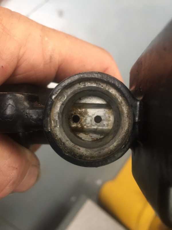

I am at work now so can't look at it, but whilst I don't wish to question your wisdom, ...are you sure there are two holes in the bore? I can see two in the reservoir, but I had a really good look and poke about with some metal wire (without scratching the bore of course), and I can only see one hole in the bore. Once the piston goes in, the system is blocked and I cannot get anything through from the rear caliper connection into the rear MC reservoir.

There are always two ports in a conventional brake master cylinder, one of which is located in front of the piston. The front port, sometimes called an equalizing port, allows fluid to move back into the master cylinder when the brakes are released. If that port get plugged - which is not uncommon if the system has not seen regular maintenance, the effect is the brakes will drag and even lock up (as the fluid heats and expands and the port is not available to bleed off the excess pressure.

After not being able to see it I decide to take the plug out and indeed there are two holes and indeed one was plugged solidly!
When trying to unplug the second hole it was really solid, so much so that it seems to have been plugged in purpose?? I think in order to open it up I need to drill it out, but before I do that, are you sure there should be two holes going from rear brake mc reservoir into the mc piston bore?

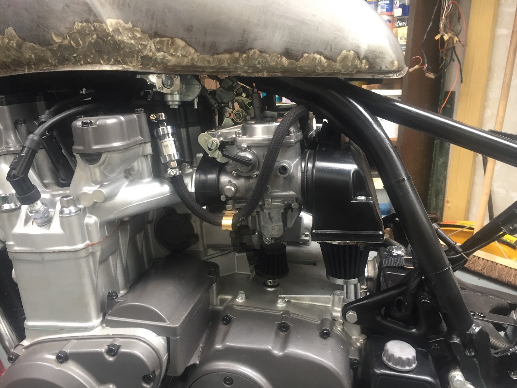

I also created the air box, but it keeps slipping off. How did you secure it?
