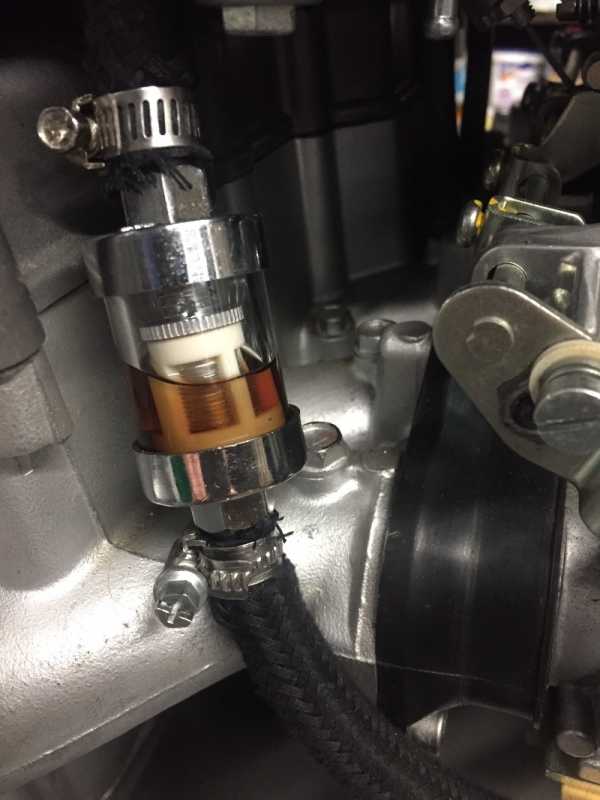

6 years 12 hours agoI suspect that whatever you selected for fuel line and installed, is not compatible with fuel and the line(s) are breaking down and discoloring the fuel (not good). I would remove maybe the line between the tank and fuel filter and swab the inside of the line with a Q-tip and if it comes out black, you have your answer.
That fuel line I see in the picture reminds me of the vacuum lines on VW's because of the cloth braid. Maybe that's what they are??

Nope, that braided line was sold to me as a 'classically looking fuel line'... fleabay...
I shall investigate, and replace as I have some Mercedes fuel line left.
