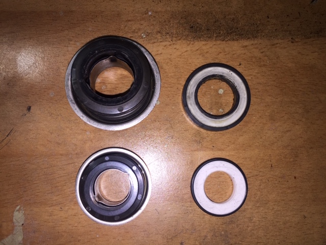

Grrr!
Mechanical seal for water pump. Old one at the top, new one below.
Wrong size!
Note to self: measure and make sure before ordering!!
Wrong size!

That's too bad Paul. Sorry to hear that.
Since you are a new face around here, you may not know my little secret about using www.Partzilla.com as a look up tool. Simple enough. Create an account and then use the site. You can find part numbers for all power sport vehicles there.
49063-1002 fits the following

it took me 5 times longer to cut and paste this info than it did to look up and figure out why the seal was the wrong size. I just think this tool is great for figuring out what parts are transferable between the ZN and the Z and the KZ 1300's In this case, I figured out what that part actually fits. Maybe you can advertise the on a local site and recuperate some of your costs.
A word of caution though. I have tried twice to order parts from them that their inventory says is available and the costs were charged to my PayPal account only to find that they didn't have the part and I had to ask for my refund. Otherwise the refund was not forthcoming

I'd suggest to stay with genuine Kawasaki parts when it comes to crucial components, unless proven good quality aftermarket. I got my mechanical seal from Kawasaki dealership - they actually had it. Also, when the time comes, although expensive - I'd get a genuine Kawasaki head gasket. At least here in Canada they have it.
