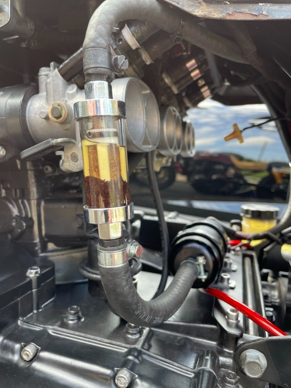

below is the fuel filter after couple min,
It was completely full with rust the first and second time
this is after the third time I took it apart and clean

I would be surprised if that fuel filter flows enough to keep up with the flow demands of the fuel injection system, it looks more suited for the much lower flow of a carburetter bike. When you see the size of the original fuel filter you know what I mean. Do you have any fault codes in the DFI control box window? I also wonder if running without air filters is affecting the running.
