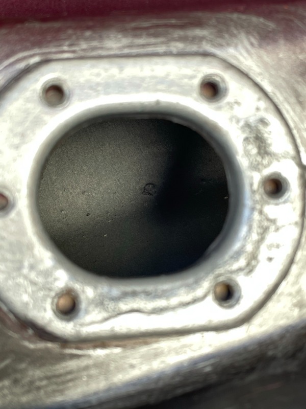

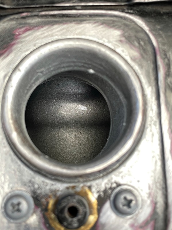

5 years 4 months agoStiggy wrote: For cleaning badly rusted tanks I have used small fish tank gravel and some diesel , kerosene or similar. Put it in shake it around , empty and flush. It will remove the rust scale and debris that would otherwise have fallen off in the longer term in normal use. A good step 1 clean before any chemical process.
Don't put the gravel back in the fish tank. :S :S :S
I used the metal rescue, it gave the gas tank a good clean.
the gas tank look good but I probably have lots of loose rust sitting on the bottom
I will try to clean with baking soda and vinegar and give it a good wash then seal it
Thank you
Eran
1984 Kawasaki Voyager
2002 Honda CBR954
2002 Honda CBR954
- Bar
- Elite Member
- Posts: 191
- Thanks: 42
Re: From 1984 Voyager to a street fighter
5 years 3 months ago
clean the gas tank with baking soda and vinegar
defiantly help but the tank always stay a bit rusty
after done washing with water I cleaned it with paint thinner and carburetor cleaner
then dry with heat gun really good
I used the POR 15 sealer and it looking good so far
I will wait cupule more days till it completely dry and use it again with gas

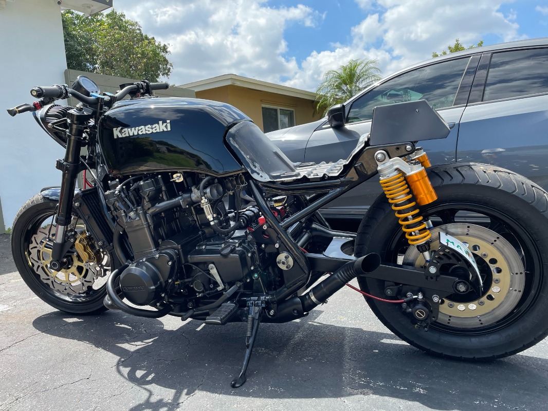

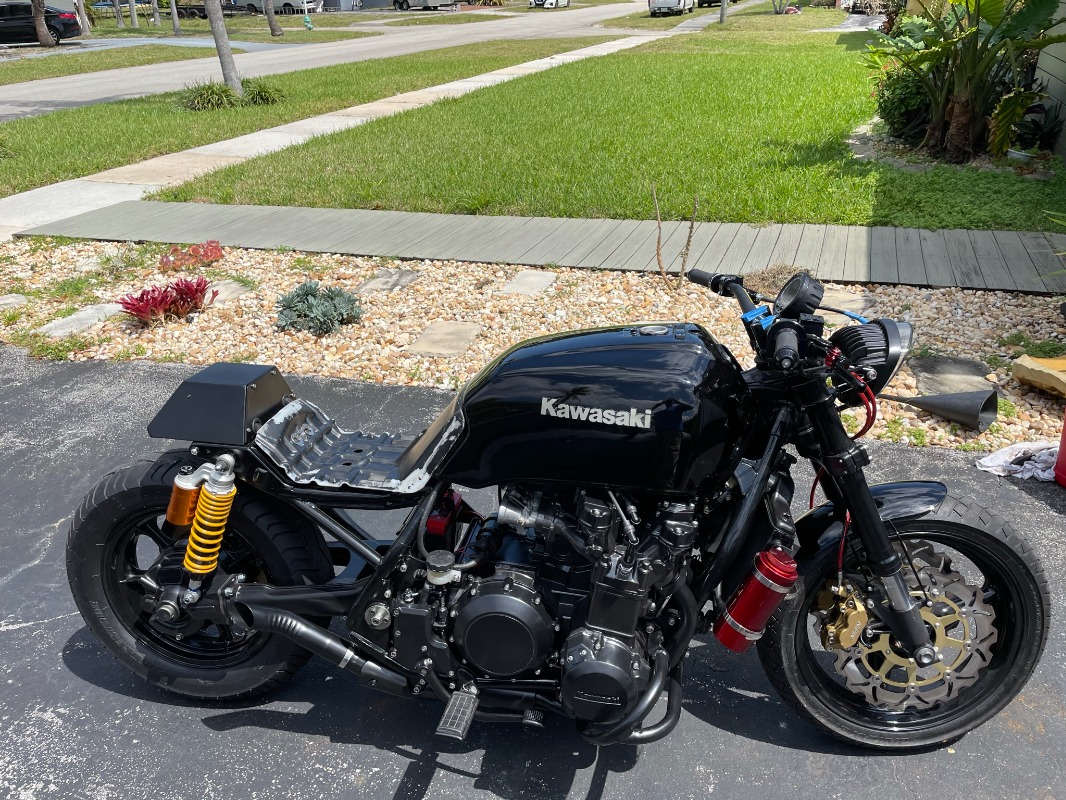

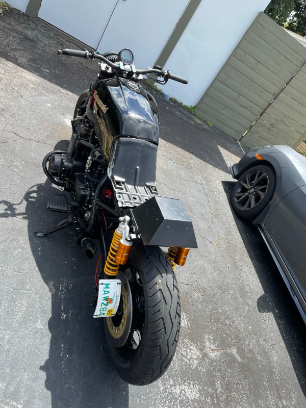

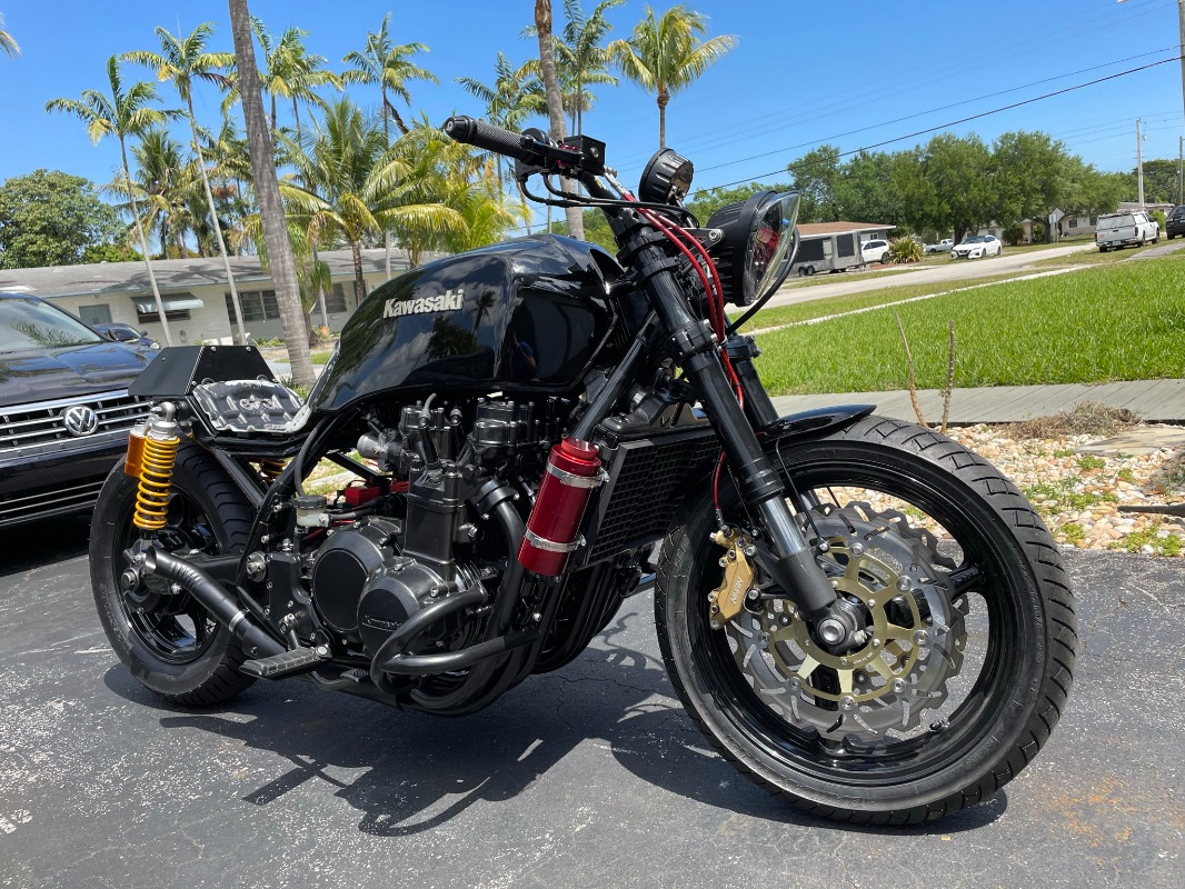

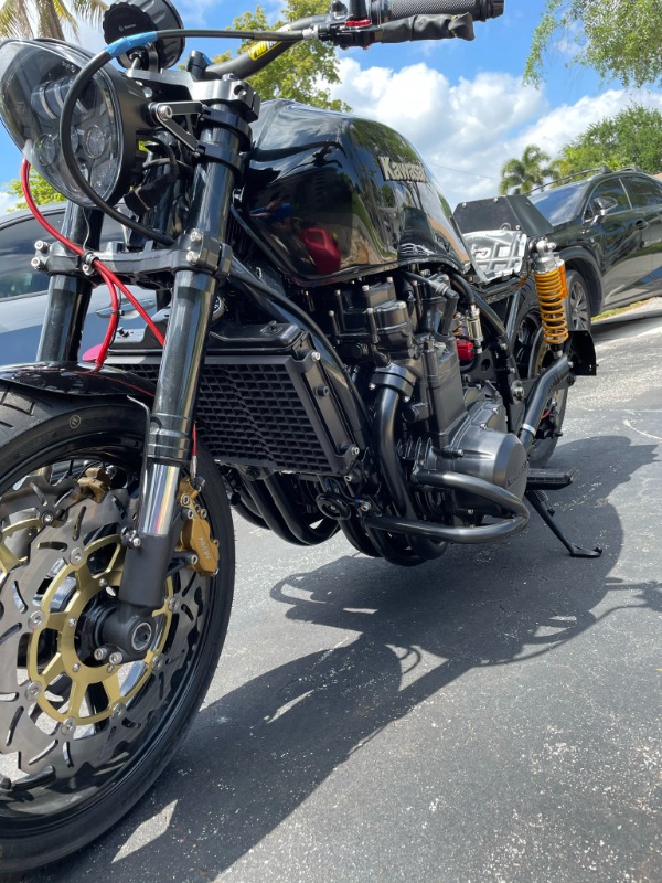

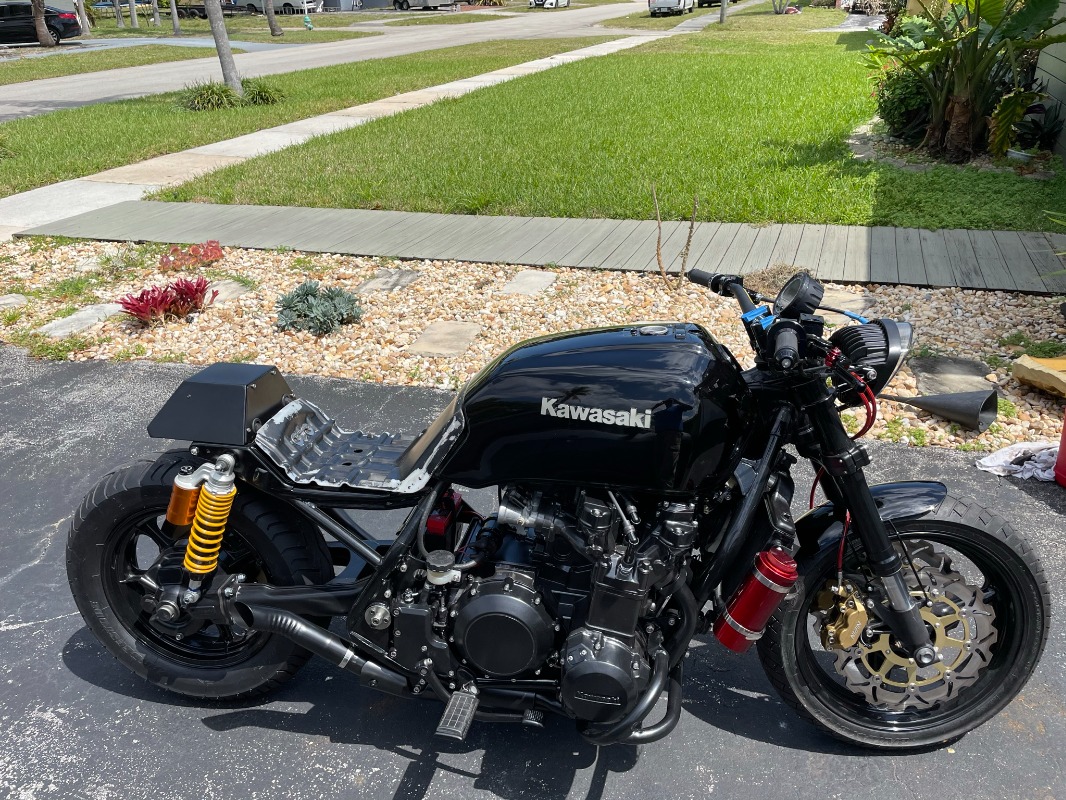

After one year in the making, Bike is almost ready
the bike starts and ride good
found the fuel petcock leaking
also going to change the red break lines to black
new clutch cable should be in this week
hope by next week to get all ready and go do the new seat

Some interesting stuff going on there Mister. Not my style, but I can appreciate what you've done.
Are you sure you have enough brakes on the rear????
I would be soooo tempted to paint that overflow tank blue and label it........
