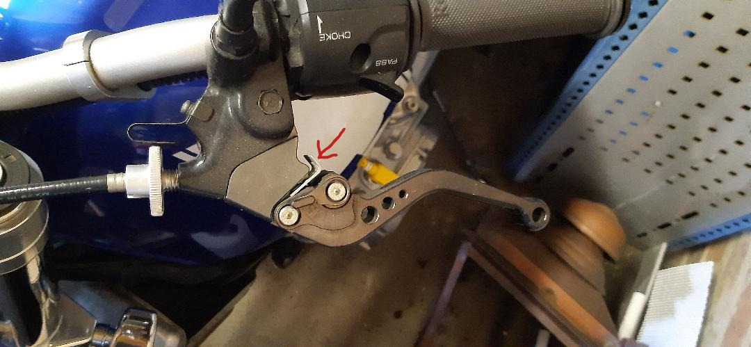

As you've found, the ZN / ZG clutch lever has a longer throw than other bikes. This was about 12 years ago: I bought a 2000s Z1000 clutch lever perch so that I could fit an aftermarket clutch lever (any modern bike clutch perch will do, I just thought I'd keep parts in the family
). I too found that the throw wasn't long enough, even with the lever adjusted all the way out. What I needed was one more 'click' on the adjuster, so what I did was fit a clip I had lying around (red arrow) which basically gave the lever the equivalent of one more click of adjustment 'out' -that gave enough throw to fully disengage the clutch. I was going to drill & fit a grub screw to the perch to do the same job, but never got round to it, the clip is still there doing it's job 12 years on. The only thing is the clutch lever is now a bit of a stretch from the handlebar, but I have average sized hands & it's still OK.
Last edit: 5 years 2 months ago by Phil.
The following user(s) said Thank You: Bar
