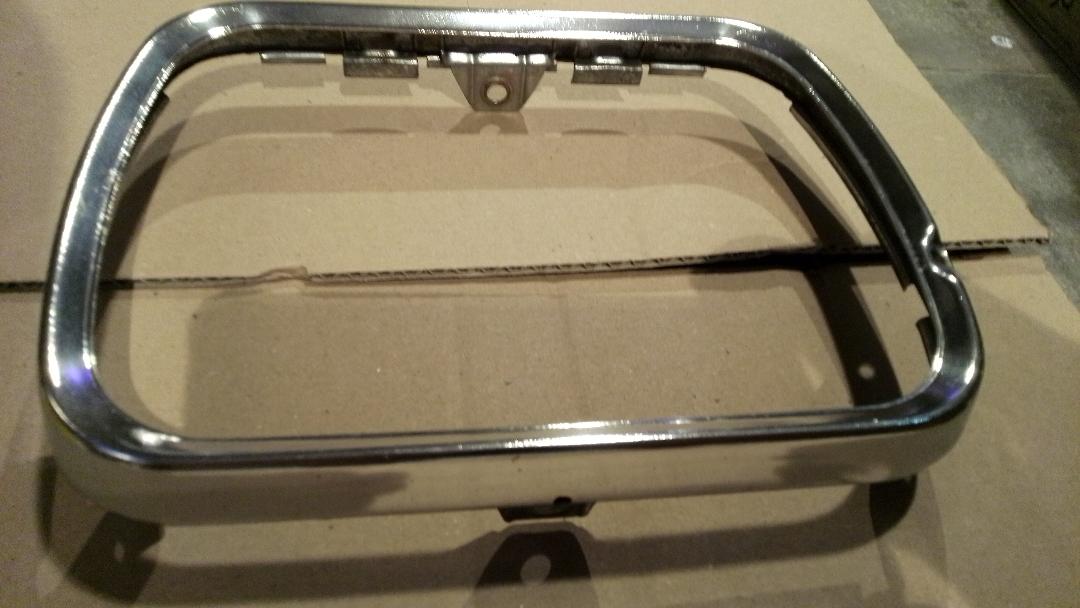

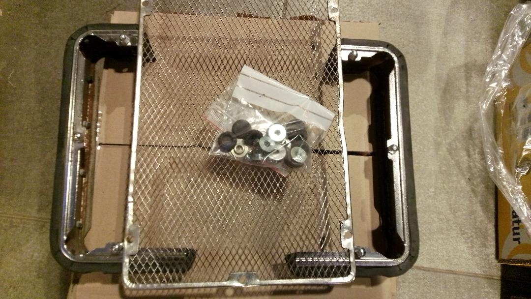

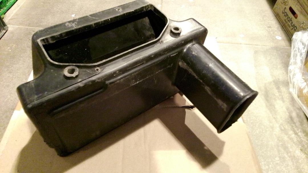

The airbox part I didn't have.
The chrome headlight ring, mine has holes from rust and is painted with the same fucking water-based paint that was painted on the engine.
The complete radiator protector, with its grille, anchors, screws and corresponding rubber bands.
If one day I decide to sell this motorcycle I am going to break with the tradition that every time a motorcycle changes owners, parts are lost.
The entire lot plus shipping costs cost me the "modest" amount of 350 euros after the seller gave me a discount imagining my stupid face willing to pay for those items.
