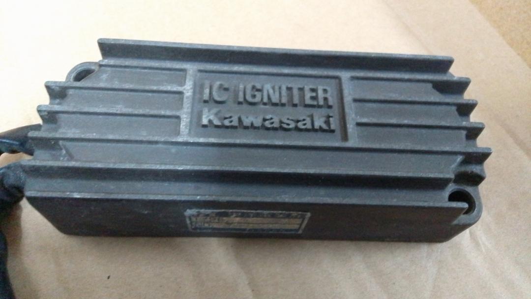

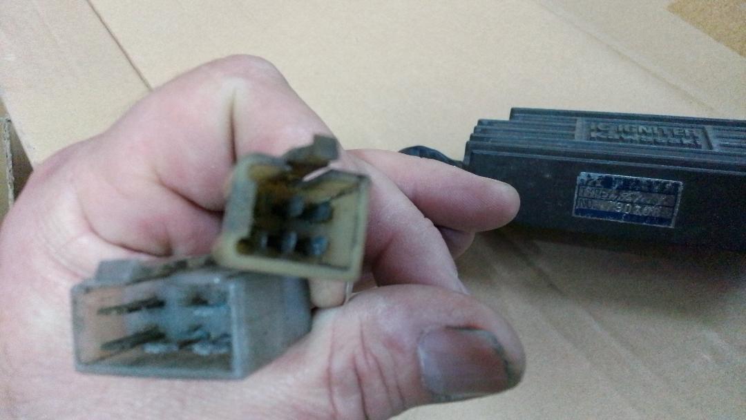

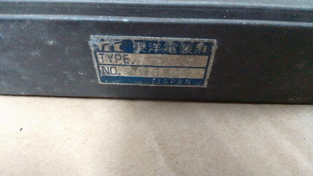

I finally received the used CDI from the French replacement dealer.
The connectors are crying out for a good cleaning.
Well, after reassembling the parts, prime the carburetors and help the battery with some additional clamps.

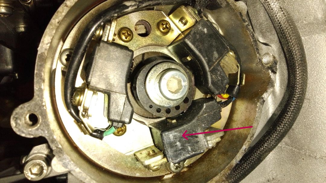

I start the engine again and the damned cylinders 2 and 5 fail again.
I remove the spark plug from cylinder 2 and there is no spark.
No problem on cylinder 1 and 3.
The fucking chronic failure of the motorcycle is repeated.

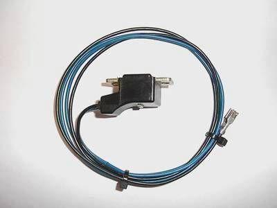

The fault comes from the pick-up.
The fault is in the pulse generator of cylinders 2-5.
It works when it wants without apparent cause.
I have already ordered a new one from MCG Parts.
Its cost is 115 euros.

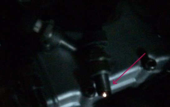

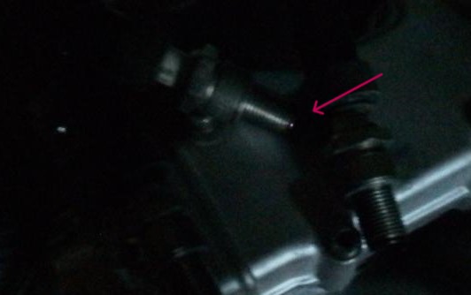

2 years 2 weeks ago - 2 years 2 weeks agoI took a couple of low quality photos at the time of capturing the spark from the spark plug.When you get it sparking again, could I ask a favor? Take a video of the plugs sparking so I can compare what I have to yours?
I was also able to record a video as requested, the quality of the video is in line with that of the photos.
From the 29th second the party begins.
The sparks correspond to cylinders 1 and 3.
Number 2 went for tobacco.
I turned off the garage light so the sparks could be seen better and to hide my mess.
