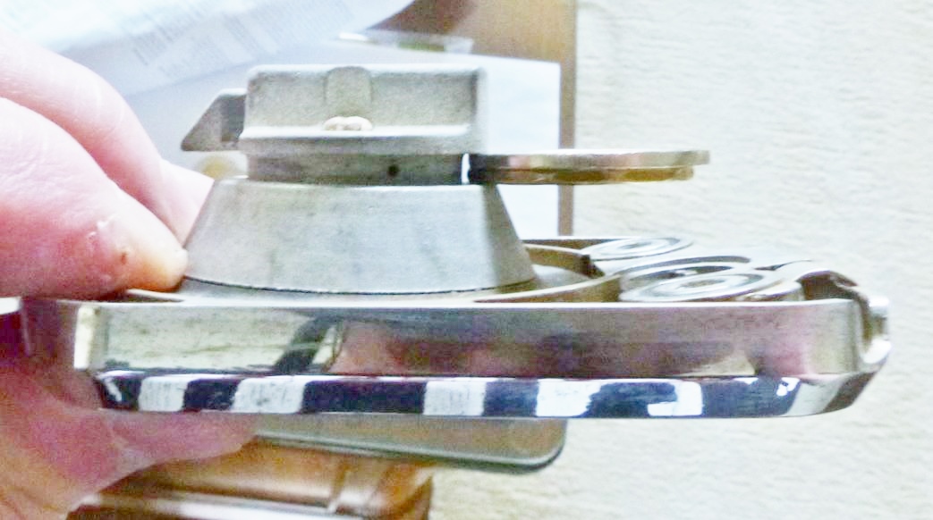

On the stock fuel tank cap, when the cap is closed on the tank, the rubber seal is compressed , exposing the vent hole in the cap (see pic)
An aftermarket fuel cap may have something similar and it might vent through the key cylinder, maybe, I don't know. Having the stock fuel cap uses the fuel vent pipe to also act as an overflow and spill excess fuel onto the ground and not allow fuel to flow out the top and all over the tank and seat, or maybe your crotch.

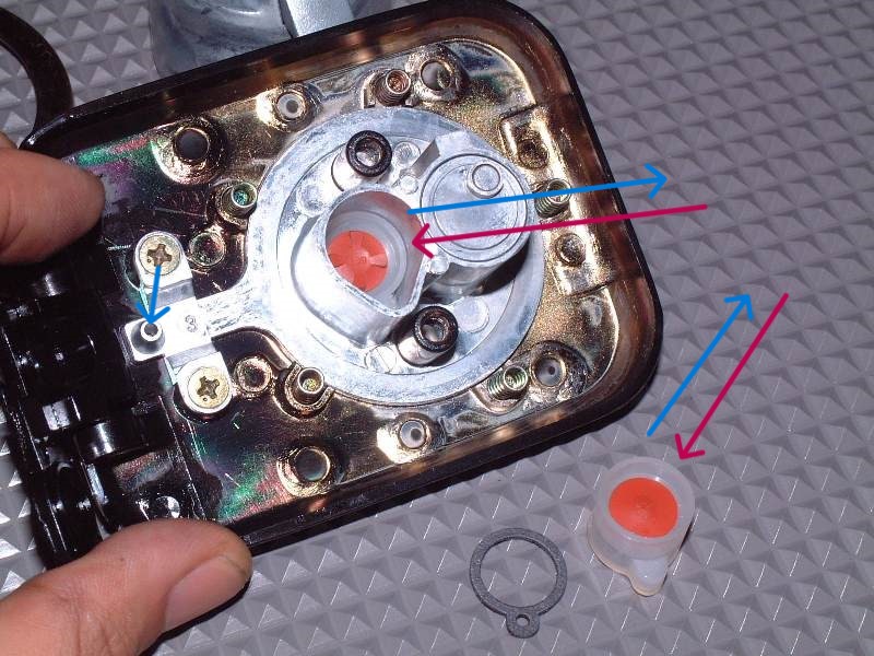

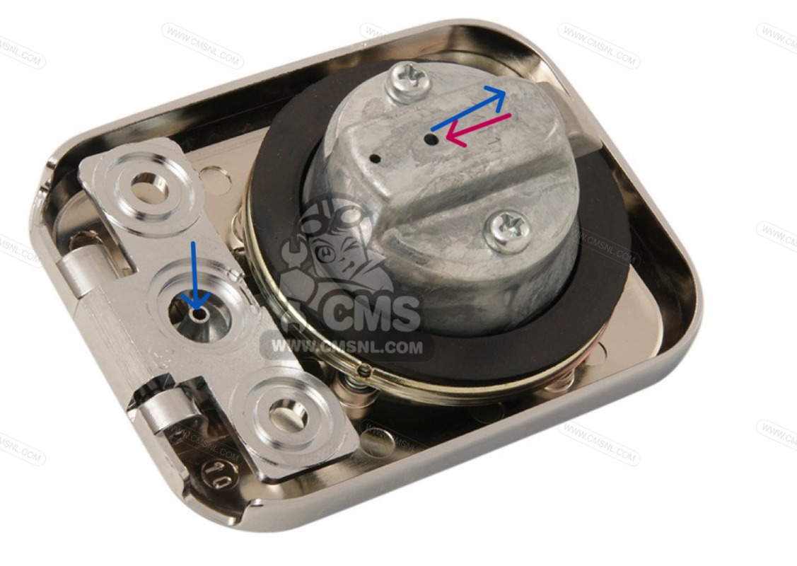

I found these photos online, you can see the complex membrane system that acts inside, letting air in, blue line, preventing fuel from escaping, red line.
In the original cap you can see the small hole through which the tank breathes.

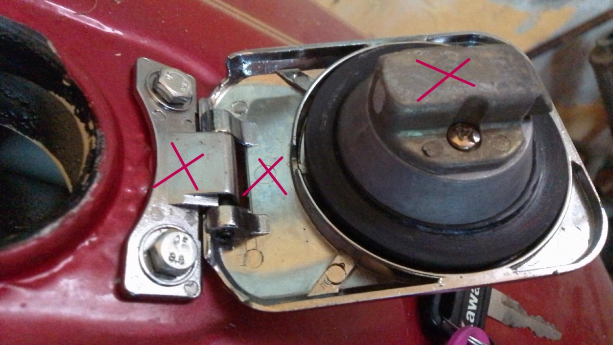

The cap that I have installed comes from aftermarket, it has no holes, no breathing system, it doesn't even look like it does its job properly sealing the tank.
Cheap is expensive as hell.

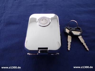

MCG PARTS.
Tank cap with two keys suitable for all models, made by Kawasaki.
Please also order the seals for the tank cap, see next three items
Customers outside of the Europe Union must not pay the German vat. Please divide the price with 1,19 then you have your price
Artikelnummer:
Price only 229 euros.
