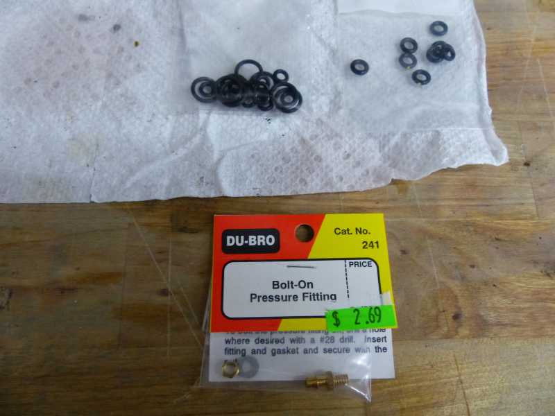

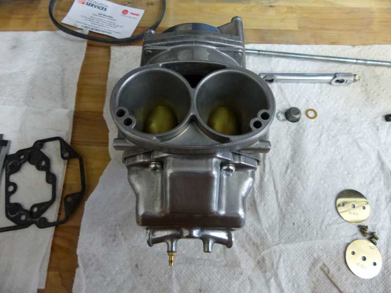

Went to Hitech Seals in Newmarket today and fitted up seals for the carbs. All seals are Viton 75 durometer.
[/Oring for the Neeedle Seat Body 7.5mm X 1.5mm Hitech part# MV8 150075 $1.39 each
Oring for Idle Air Needle 3.0mm X 1.5mm hitech part# MN7 15003 $0.75 each
Oring for carb bowl drain screw is a part #007 since there was no metric equivalent that fit correctly. cost $1.05 b]
I asked about the lip seal for the throttle shaft and they couldn't spec out a seal, so the search was on. Thank God for the internet. After about 2 hours of searching, I stumbled onto a website forum for the XS650 Yamaha and a thread on changing out the throttle shaft seals on their Mikuni BS34 carbs. Would you believe the throttle shaft and the carb shaft bores are identical AND the seals are still available YAMAHA part # 256-14997-00-00. Called up the local dealer and ordered 6 @ $5.95 each.
[/YAAHOOOOOOO!!!!!b]

Here's a cute little mod for the drain fitting on the carb bowl. Go get yourself one of these from your model shop,
Drill (clean out) the drain fitting on the carb bowl with a #36 drill bit and tap with a #6-32 tap and install. VOILA!!
Now you can add a piece of 2mm tygon tubing for your wet float test. I'll make up a bracket to come off the side of the carb bowl screw and add the tygon tube. The bracket will have the 6.5mm-8.5mm markings on it. (soon to come)

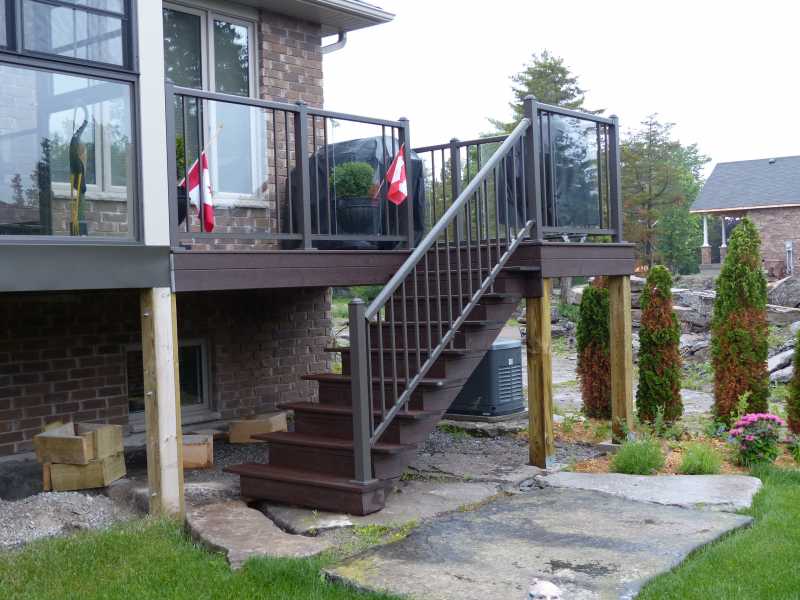

We wanted a wing deck for the BBQ but the builder wanted stupid money for it and I said I would do it. So here it is.

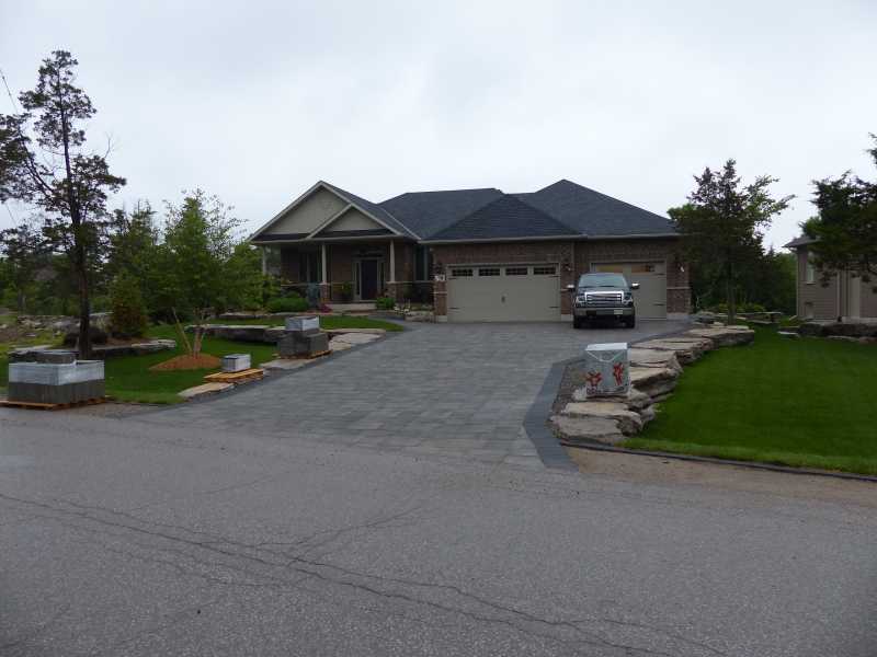

then we needed a driveway. We could have had it paved with asphalt, but for the same money I could buy concrete pavers and just do the grunt work and put in the driveway. So here it is.

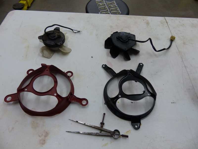

So, I have time now to spend back on the project. For what ever reason I decided to pull out the rad fan and look at it. There a few posts in the FAAQ section about overheating issues and although I personally believe there's no engineering problem associated with the original design, I've elected to update the rad fan just because I can.

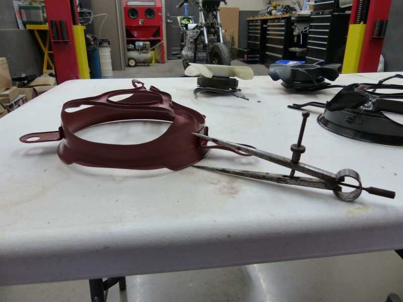

I've picked up a ZRX1200 rad fan from EBay for $40.00. It's a 7 blade design with similar lift in the blades and at first it looked like I could just remove the motor and fan blade and bolt it right in to the old shroud, but of course the bolt pattern was off just enough that I would have to really bastardize the mounting holes to get things bolted up, so I've elected to cut the top half off of the ZRX1200 fan shroud and the bottom half off of the old shroud and weld the 2 shroud halves together. In order to get the right height for each of the pieces I've marked the 2 shrouds with a set of dividers referencing by placing the shrouds on a table and measuring up from the table. That way after it's all welded up the fan blade will be located in the same place as the old fan blade was.
