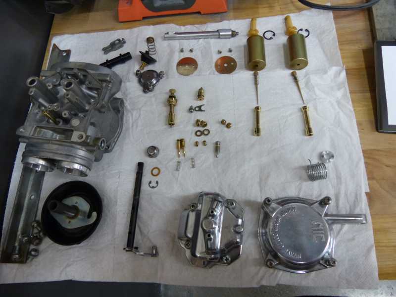

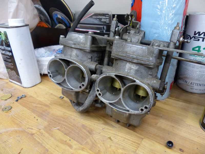

One carb cleaned and flow checked. Ready for assembling as soon as I get the O-rings and u cup seals.
From this
to this
From this
to this

Stumbled across a good one today. I started pulling the second carb apart. After I removed the screw and retaining clip from the float needle seat. It just fell out. The o-ring between the carb body and the needle seat was shrink enough that it wasn't sealing and that got me to wondering how many other members are struggling with flooding or issues trying to set their floats. If that o-ring is passing then there's nothing stopping the tank from spilling fuel into and through that carb.
- scotch
- Posts: 2028
- Thanks: 931
Re: Kawboy's restoration/conversion of a 1980 KZ13
11 years 3 months ago
RE: The needle-valve "O-ring".
That is quite surprising to hear. The '79's I rebuilt had the original "O-rings" that were by know means tight but were still making OK contact. I replaced them. My OEM '80's were the same when replaced about 10 years ago. In both cases still flexible enough to remove in one piece.
Regardless. If the valve-body "fell" out, then yes - you had a problem! Strange that the first carb didn't do the same thing which would lead me to believe your "offending" "O-ring" was a "repair" "o-ring" of a composite that.....shrunk. It will be interesting to hear of your situation with the third carb, when you start on it.
This will make some "cringe" but this is why every winter I remove and completely tear-down the carbs. It keeps the screws "screwable" and allows the opportunity to check on things like "shrunken "o-rings" and stuck 'enrichener-valves", etc. when you have the time and place to do this maintenance rather then being stuck on the side of the road !
Nice work on the first!
