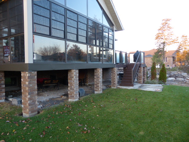

We wanted a wing deck for the BBQ but the builder wanted stupid money for it and I said I would do it. So here it is.

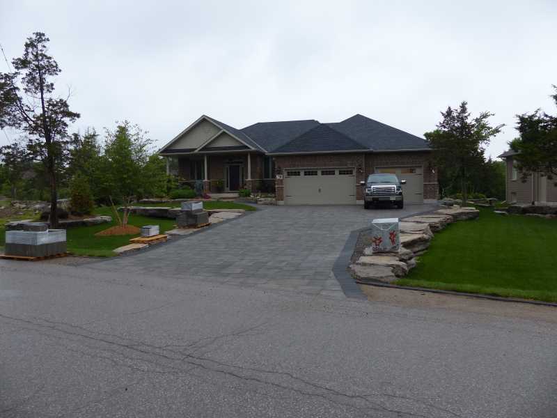

then we needed a driveway. We could have had it paved with asphalt, but for the same money I could buy concrete pavers and just do the grunt work and put in the driveway. So here it is.

So, does the new house have as much shop space for playing in? As usual, the house work is as nice as the bike work! Once again, Kawboy, we are so much alike! I can't stand to pay someone else to do what I can do, and even better, just for the sake of expediency! Very nice looking driveway! I love the choice of pavers! Nice deck, too! Do the posts get painted too?

The garage is 1350 sq. ft. I use 750 of that space for "my" shop area which is the outside bay 15 ft. wide X 50 ft. long. It works and I can't complain. It's nice having all this in a subdivision dedicated to retirement lifestyle so I get what I want and the wife can have all of the socializing she can take in the community. We traveled all across southern Ontario to find a community like this that would also build my garage onto the house. From the front you wouldn't know the garage is slightly smaller than the 1980 sq. ft. house. It just all works and looks like it belongs. Needless to say, all the men in our subdivision are envious of the garage since all they have is a 2 bay garage at 400 sq. ft. (20 x 20).
Trikebldr- Do the posts get painted - No since posting the pics I bricked them all up (all 6 posts) with 650 bricks I found laying around the lot then capped them off in aluminum.

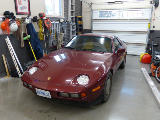

Also got back my other baby from the paint shop. It's been there since Oct last year.

Love the 928 I had one a few years ago and have always regretted selling it though it was an auto and i'd prefer a later series in a manual.
