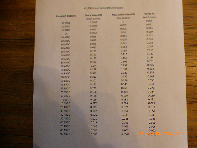

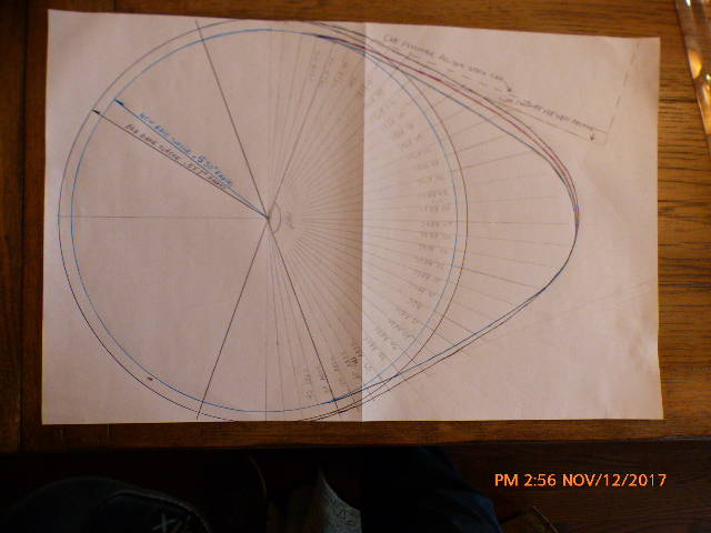

I've spent about 50 hours mapping out the stock cams and determining the faults that I could see. I needed to gain .6mm to .7mm in shim allowance to bring my average shim size back to 2.7mm. By removing .027" (or .7mm) from the base circle, I gain back the shim thickness to put me back into a good range. Now I needed to clean up the duration. The stock cams had 180 cam rotation instead of 140 degrees which translates to 360 derees of valve duration instead of 280 degrees of valve duration.
Next, I had an opportunity to look at the effective valve lift at various points in duration and see what I could do to improve the lift at various points of the duration bearing in mind that if I go to agressive, the cam could start slapping the valves open and closed. The flanks of the lobes need to have a radius so as they ramp up the cam follower, they roll into it rather than flatly approach it and ramp up. I also had to keep in mind that I needed to work with the stock cam and not add any material to it and also not grind off a lot of material to affect the hardness of the cam lobes. It took a lot of finiggling to achieve what I believe will be a "better cam". So the chart shows the stock cam, one profile that I worked out and determined that it was slow to get going and then the second profile which maintains or betters to stock valve lifts and cleans up the faulty duration.

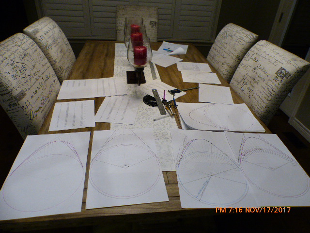

8 years 7 months ago - 8 years 7 months agoI call this masterpiece "Kitchen Table Engineering" My wife thinks I'm nuts Quote "All that trigonometry gives me a headache !" she said.
I don't have an engineering background although at one point in my previous life, my boss felt that it would be great to have me supervise 10 of his engineers to teach them how their engineering comes to fruition. I have sketch designed tooling for the nuclear power plant and the only way the tooling could be used, was if our engineering department "reverse engineered" the final product and then rubber stamped the drawing.
The picture represents well over 100 hours of drawing, measuring, analyzing, scrapping and redrawing until I finally came up with the final drawing for the camshaft grind. I've managed to increase the acceleration of the opening ramp slightly better than the stock, given more time for the decelleration to allow the camshaft to pass off the valve face to the valve seat, clean up the duration from a very sloppy 340 degrees duration back to 280 degrees duration and increase lift by .028" to .248" I also managed to overcome the issue with the valve seats ground too deep in the head. i should now be able to use 2.70mm- 2.80mm shims
9 drawings with 2 or 3 profiles on each. 5 Excel spreadsheets with comparitive data on each. it's been a crazy journey so far. Now it's time to design the profile grinder for the baby lathe and have at it.
