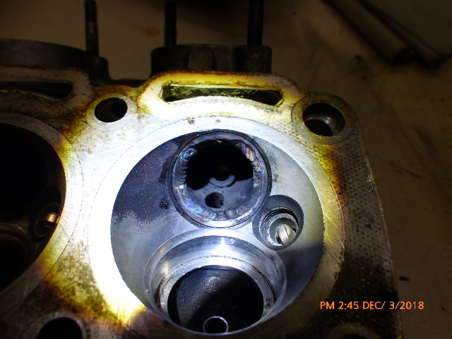

I just pulled out an exhaust insert. Laid a bead of TIG, no filler rod on the full circumference of the seat and before I touched it, I snapped a picture. You can just see the edge of the insert pulled away from the cylinder head. As I was doing this it was obvious that the edge of the seat was away in some areas and not in a couple of other spots, so I hit the tight spots again with the TIG torch until I could see the upper edge pulled away on the full circumference. After it cooled (maybe a minute) I pulled it out with my fingers. Had I turned the head over, I'm sure it would have fallen out. And what was left in the counterbore was a totally unmolested clean as a whip bore which is ready for a new seat without machining.

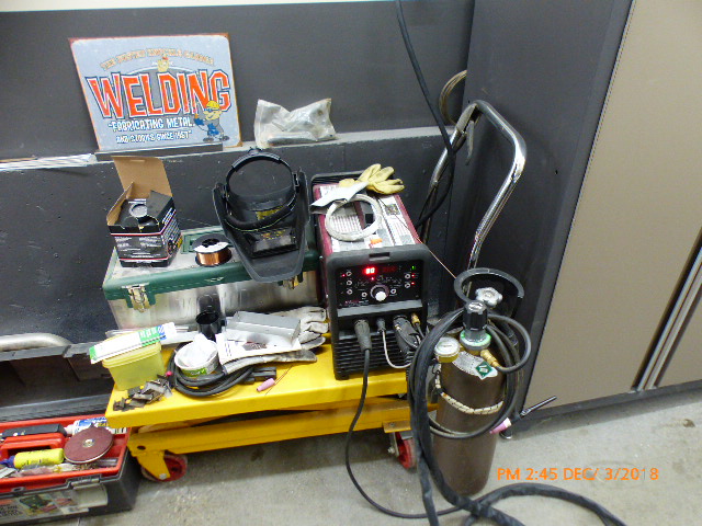

Shot of my ThermalArc 180. I had it set for 80 amps to lay the bead.

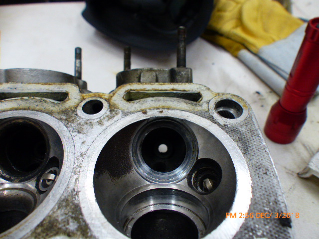

Shot of the #1 cylinder. Intake insert already removed. As I said "Learn as you go". On this one I laid a bead around most of the insert but stayed away from the area where the intake and exhaust inserts meet thinking that the material in the head was a little light in this area and I didn't want to misshape it. The result was that I needed to pry the insert out and in so doing marked up the base of the counterbore slightly. So I have a little cleaning up to do before putting in a new seat.
This time on the exhaust seat, I laid a bead around the entire circumference and the seat just fell out, so this is how I'll proceed.

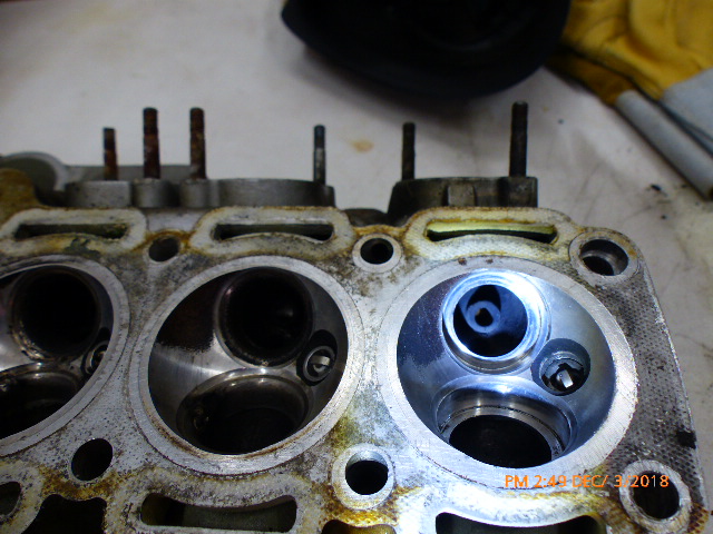

This picture is of #2 combustion chamber. I had a go at laying a bead on the intake and I must confess that the sputtering and porosity gave me the willies so I stopped and tried #3 intake. Same thing. Once the initial burn off of the impurities, the seat material started to fuse but that initial burn off is like a welder's nightmare.
Anyway, the purpose of this pic is to show you what the insert looks like before touching it with the torch. You can't see the insert to chamber edge. The aluminum is polished and the seat is polished. It's almost a guessing game.

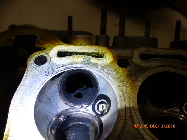

This pic is combustion chamber #1 with both seats out. You can see (hopefully) the nice clean counter bore for the exhaust insert to be placed in.

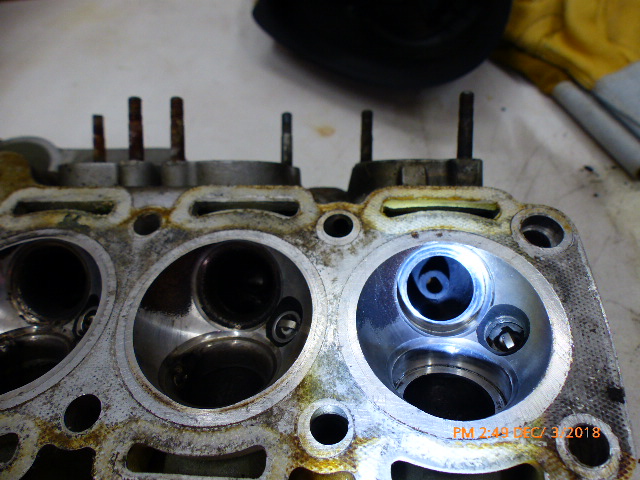

Same pic as the last one only different lighting. (Don't know which one shows up better.)
