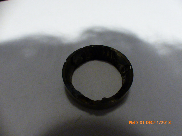

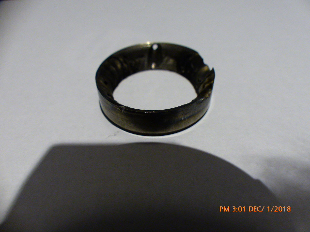

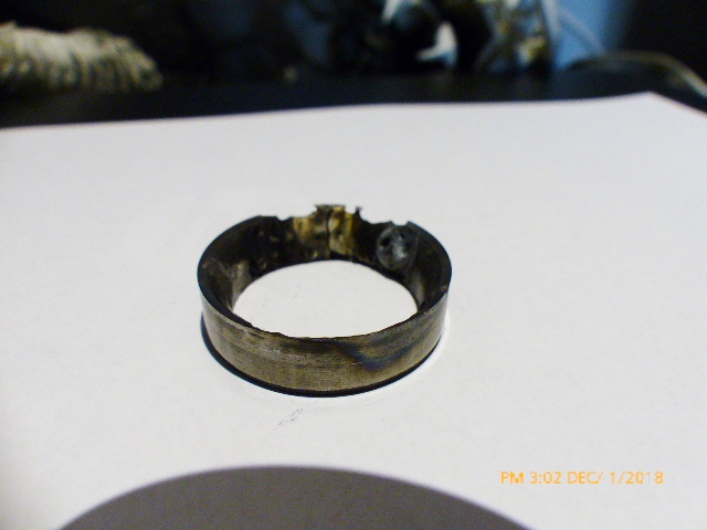

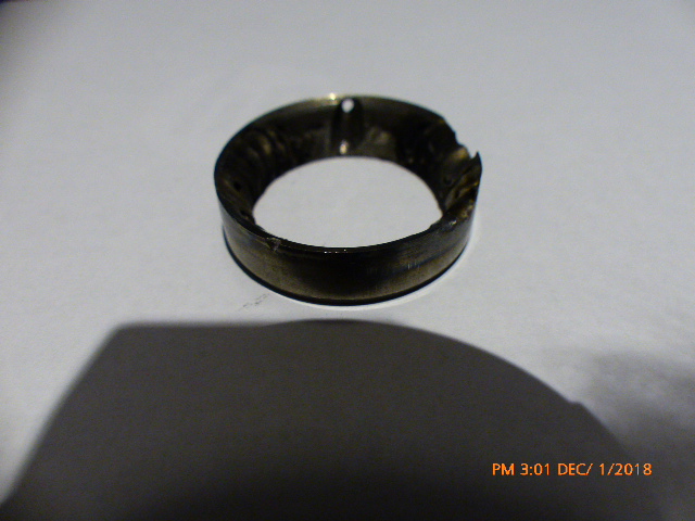

In a previous life I did valve seat replacement using a tig torch to lay a bead on the inside of the seat which sucks the diameter inwards and the seat will drop out. So for shits and giggles I got the tig torch out and had a go at one of the seats. First time around a little scary. Popping and sputtering, porosity, just ugly. After a second pass things settled down and the seat material formed a bead so I guess the seat was contaminated with oil and carbon which must have burned off.
Here's a couple of pics of what a seat looks like after laying a bead and popping it out of the recess in the head. And for the record, the recess is as clean as a fresh cut recess.i could just warm up the head and drop in a new seat.
