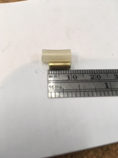

3rd test. Bike has sat for 6 full days. Turned on fuel, listened to bowls fill, touched the starter and it fired up immediately, again. Reduced the choke for a 1200 RPM warm-up idle.
This appears to be the solution to the notorious hard start problem and the modification is remaining as installed.
Amendment: I screwed-up when I cut the brass and silicone for the picture.:pinch: Sorry 'bout that. :oops: Reverse the lengths !!!!! The exact lengths are not critical but the brass tube must be longer then the silicone tubing.!!!! Neither can extend into the choke-piston well (for obvious reasons) !
Reverse the lengths !!!:silly:

Another immediate start after sitting since the last weekend !
Then an outrageously enjoyable 126K "scoot around the patch" !
This bike is simply too much fun !
If you've got a "Hard-Start" issue.....pull up your panties :blink: and try the Choke-Air mod. It'll take a couple of hours and YES the carbs have to come off and YES the lids have to be swung out of the way to remove the diaphragms............ but it works !
Or you can continue to try blowing up the engine with starter fluid and wearing out the starter and it's mechanism.:pinch: It'll cost you about $3.00 for the silicone and brass.:pinch:

It would be very interesting to see if an unmodified set of carbs will start a new engine easily. That was the premise when I suggested this. So now you're the "guinea pig" ! :whistle:
If you do have starting issues.....you know what to do !
