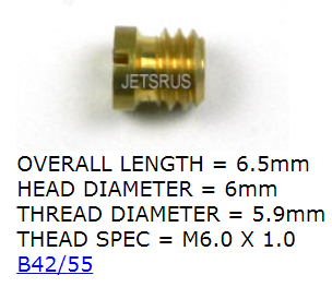

The Final Solution: Tapping a few threads is simple and for myself this is not only the easiest method to restrict the choke-air port; it is the most discreet and "factory" in appearance.

In other words, like with many problems, the best solution is - ah.. screw it! :woohoo: :whistle:
