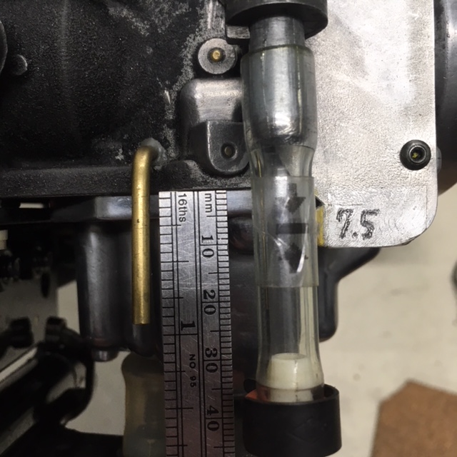

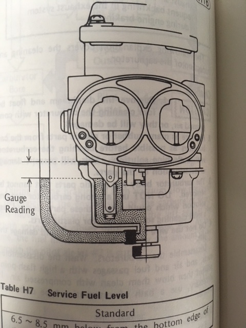

So perhaps I'll start with a one time :huh: apology because clearly this hasn't been clear ! :S Hope the pictures put a lid on this. The manual refers to "the Bottom edge". I have been referring to this as "the Lip" in an attempt to be more clear. Potatoes/Potahtatas - Tomatos/Tomahtas? :woohoo: So the measurement is taken from the "Bottom Edge" hence forth to be referred to (by me,) as "The Lip".)! :kiss: Again note that the 7.5 mm level is approximately in the middle of the small "bulge" on the side of the bowl.

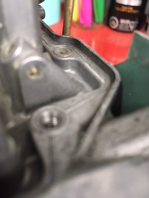

Pictures do paint a thousand ... (ambiguities!) but you've quite rightly reminded me of that thin lip around the gasket surface.
The sneaky 6" steel rule slipping between the two surfaces is again a good technique, once the gasket interference is eliminated or accounted for.
Clarification understood and appreciated! : )

That's it Stan, and makes sense that Kawasaki would reference an edge that is visible / accessible, rather than one partially hidden.
