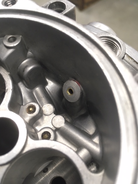

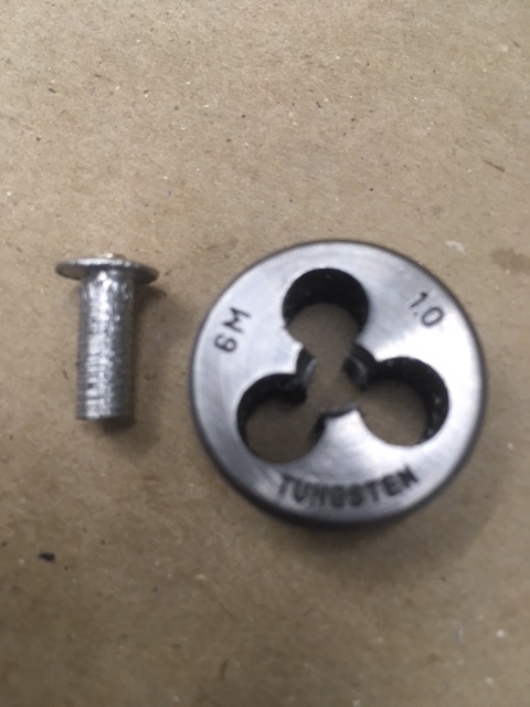

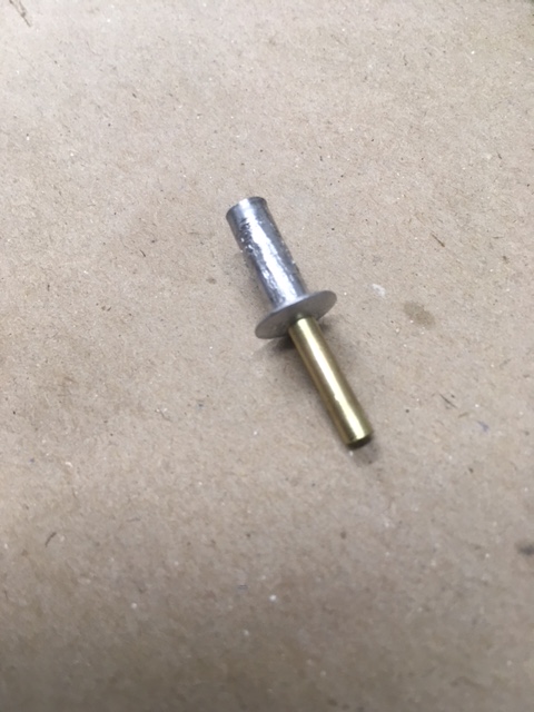

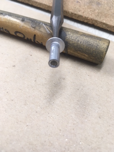

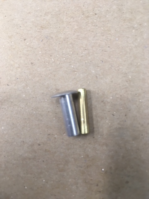

Another option which looks more Professional/Factory(?) Adaptions to the principle idea are encouraged so long as a full 7/32" (I/S dia. of the "1/8" brass tube) opening is provided and centered in the air port.
3/16" X 1/2" aluminum Pop-Rivet swedged with a 1/8" pin-punch with a piece of 1/8" brass tube pressed into it. A die is run-down the rivet to displace some material for a snug fit into the air-port. Not much more then scoring the rivet - Not looking for, nor want a full-thread depth !
Push the restrictor into the air-port A drop of thread-lock may be used if your comfort level requires it.

Looks red there, did you apply red Locktite or drew blood from the carb?
