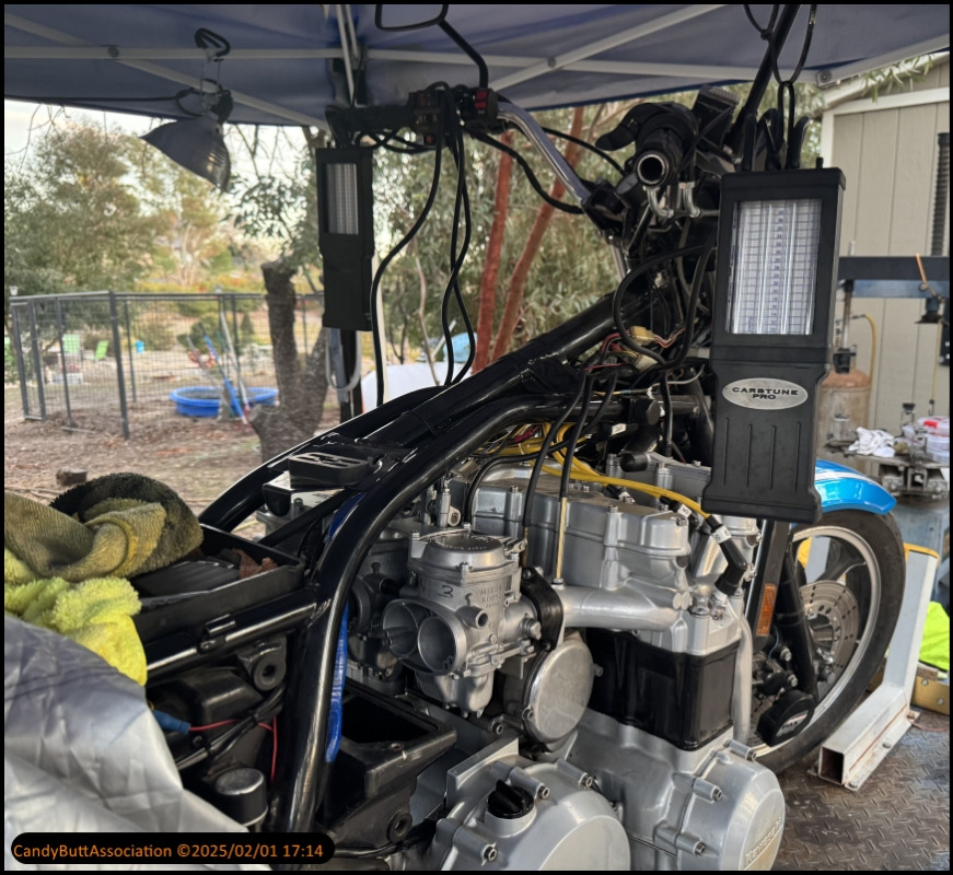

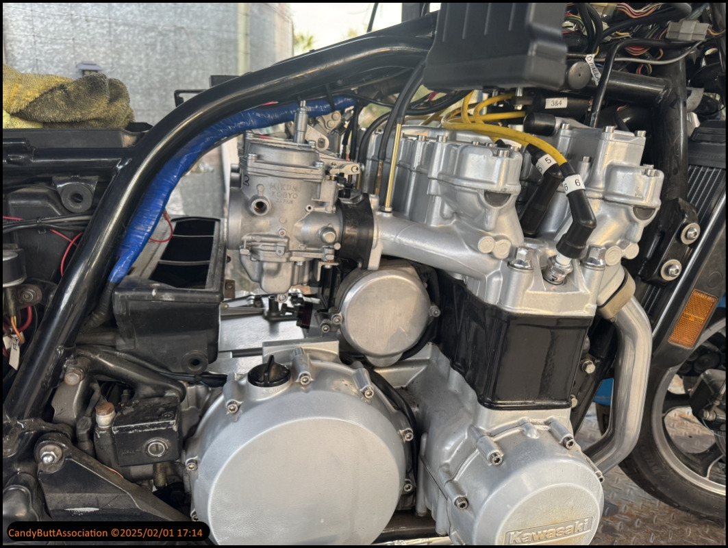

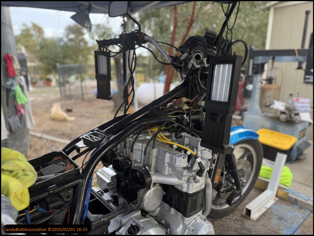

2025-01-31 Install Rebuilt Carbs

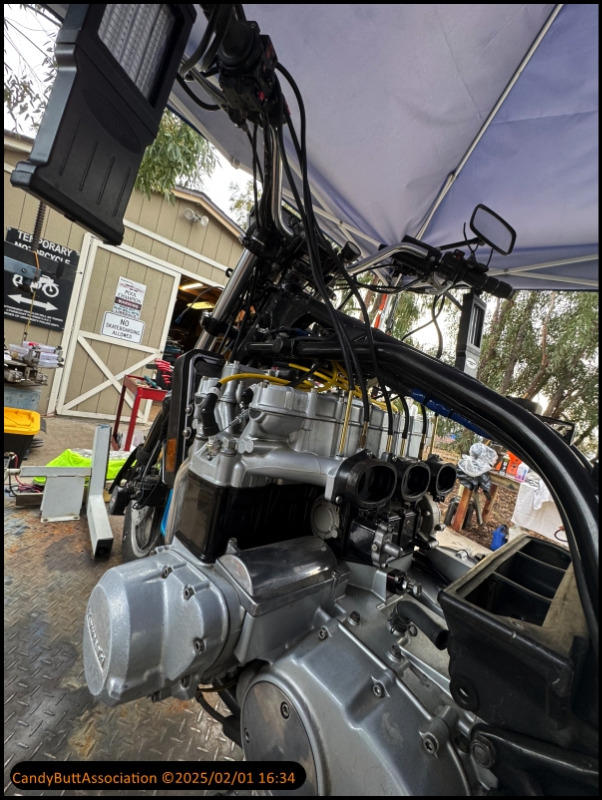

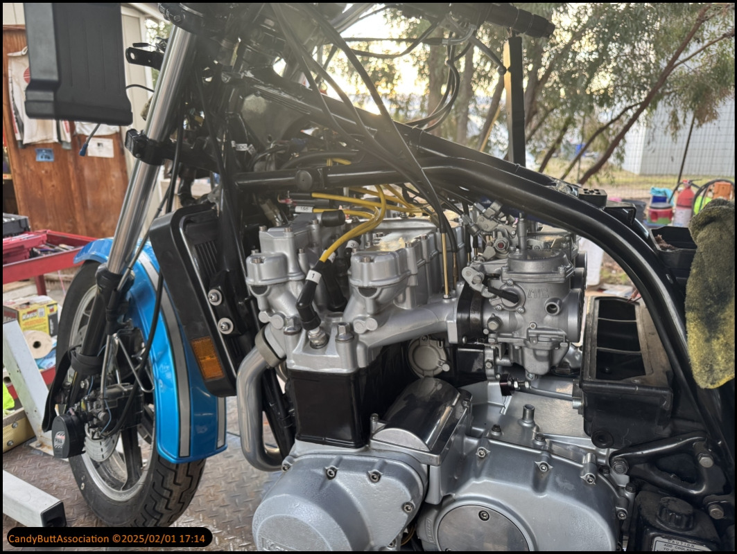

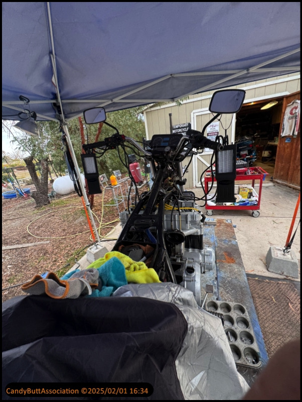

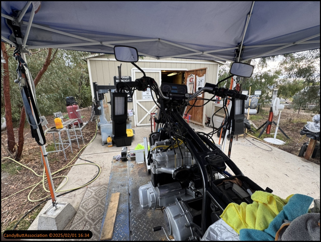

Before installing, checked that all screws were tight, but the bench synchronization was correct.
Installed the vacuum extensions before plugging the carbs into the boots. Easier that way.

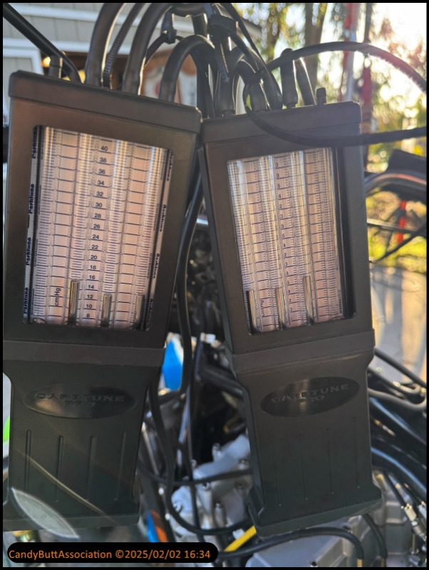

Manometers hung. I even checked that the restrictions in the tubing were the same for all six.
Pulled the spark plugs they all look good.
Installed. And clamped down.
I sure hope this works.
I would like to ride the bike while the weather is still cold..

So I performed a rough running synchronization. Here are the results.
At this point, the bike is idling very well, and is very responsive to throttle. I am kind of debating whether to mess with it or just let it be.

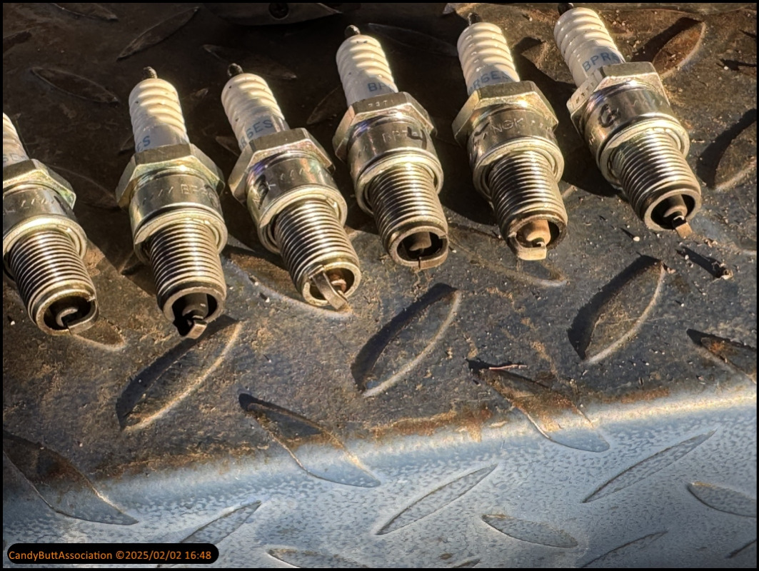

I pulled the sparkling plugs. Here is the result. One through six left to right.
I don't know why, but the picture makes the plugs. Look better than what they are.
Number one looks a bit oily, to a bit sooty, three is wet, four is sooty, five and six look great.
Is it a coincidence that five and six had the carburetor that adjust correctly?
