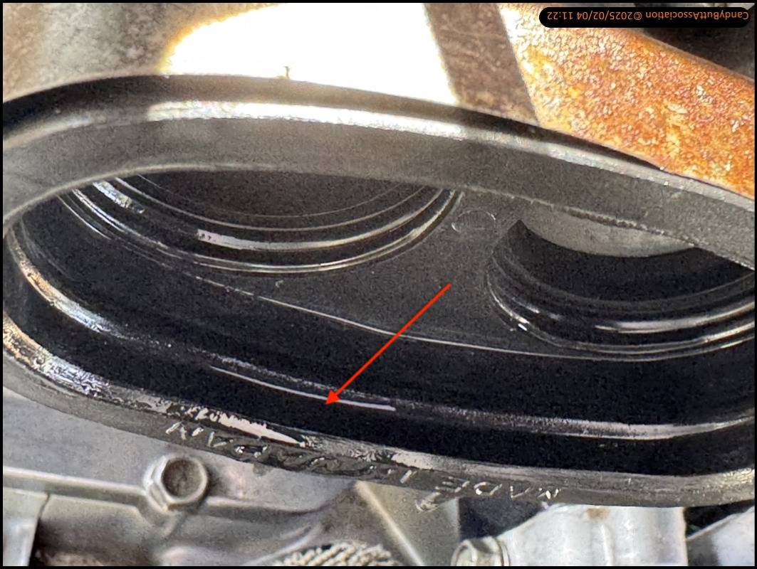

I noticed some 'wetness' on the external carb inlet boot on carbs 1, 2. When I pulled the carbs, I saw some fuel 'pooling' on the boot inside, making me think the bowl is leaking fuel directly into the cylinder, resulting in over-rich conditions.

Your wet boots may be due to "Fuel Stand-off".  Caused by the relatively quick opening and closing of the throttle.
This is an extreme example:
Interesting. I can see this with a race engine with big overlap on the camshaft. I should've been more specific, too as two of the three boots are wet and the third boot, cylinders five and six, which are burning nicely and respond to pilot. Circuit adjustment are dry.
"In instances of standoff the air/fuel charge is drawn down the intake runner and past the open intake valve. When the valve slams shut a reversion pulse like a shock wave is reflected back through the stream. This harmonic pulse pushes back the charge, and back-flows the venturi. Because this pulse has inertia and velocity it forces the atomized fuel the wrong way out the throat of the carburetor."
In case any is wondering, here's a link.
