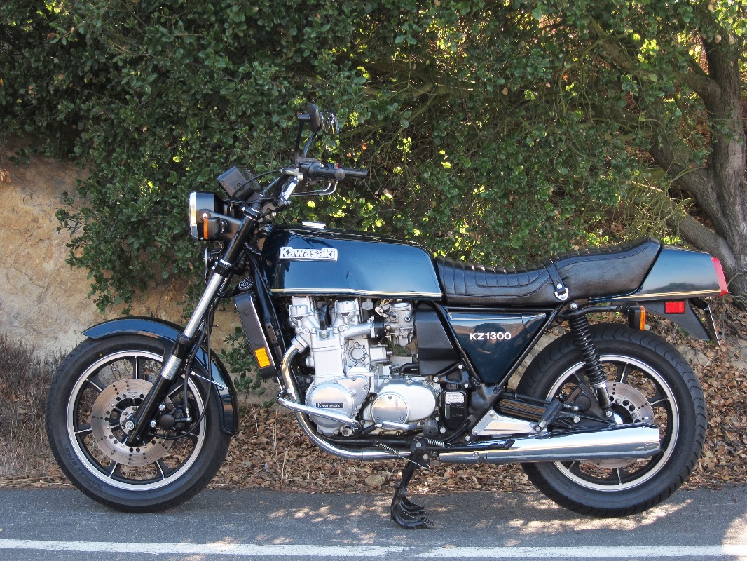

That's 1 beautiful looking 1300. Love the paint. I can see the metalflake down below. Must be hard to look at in the bright sunlight. The rest of the bike looks spectacular.

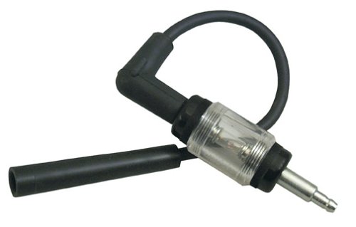

Ron wrote "I have this tool that checks for spark (a small clear plastic tool that you put between
the plug and the plug cap) and it shows that there is spark, I tired a new plug then thinking
maybe the plug fouled, still no spark. I’m lost… would appreciate any help. Thanks, Ron. kz1300.JPG"
Does this "tool" look like this?
If so, that will show if a spark is being generated, flowing down the spark plug wire , jumping the gap in the tool and having a pathway to ground. That indication will show even with an oil fouled plug because the plug is now shorted to ground completing the circuit. The tool will not tell you if the spark plug is shorted and oil fouled. if it ran the day before and then dies on 3 cylinders when you started it up the next day, there's a strong possibility that some of the plugs oil fouled

Yes, this is the tool i have.
So how would you explain a new plug not sparking? ( and the tool shows that there is a spark)

So this is a shot in the dark here. On a wasted spark system, the spark travels down one of the spark plug wires to the plug, then across the spark plug gap and to ground, then across ground (cylinder head/block etc) and then jumps the gap on the other spark plug of the same coil and back to the ignition coil to complete the circuit. So that being said, did you by chance have the "other" plug wire for that coil off of the other spark plug spark plug when you did your test? ie. testing the new plug on cylinder #5 plug wire and at the same time have the spark plug wire off for #2 spark plug.
What I'm trying to explain here is the basic wasted spark system and there's lots of info on the web about it.
