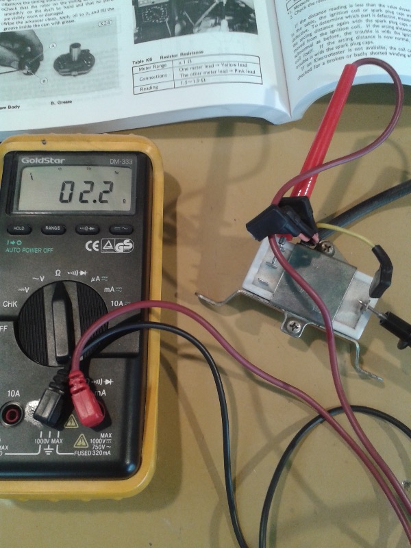

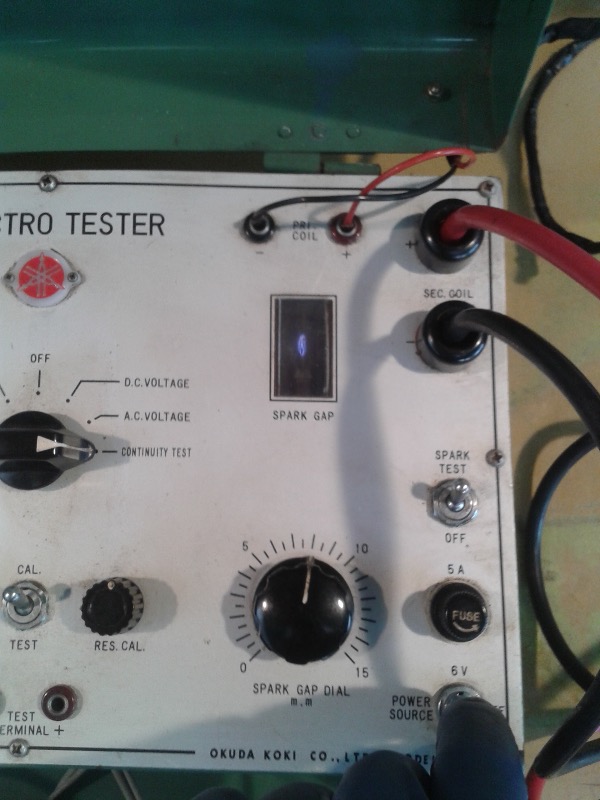

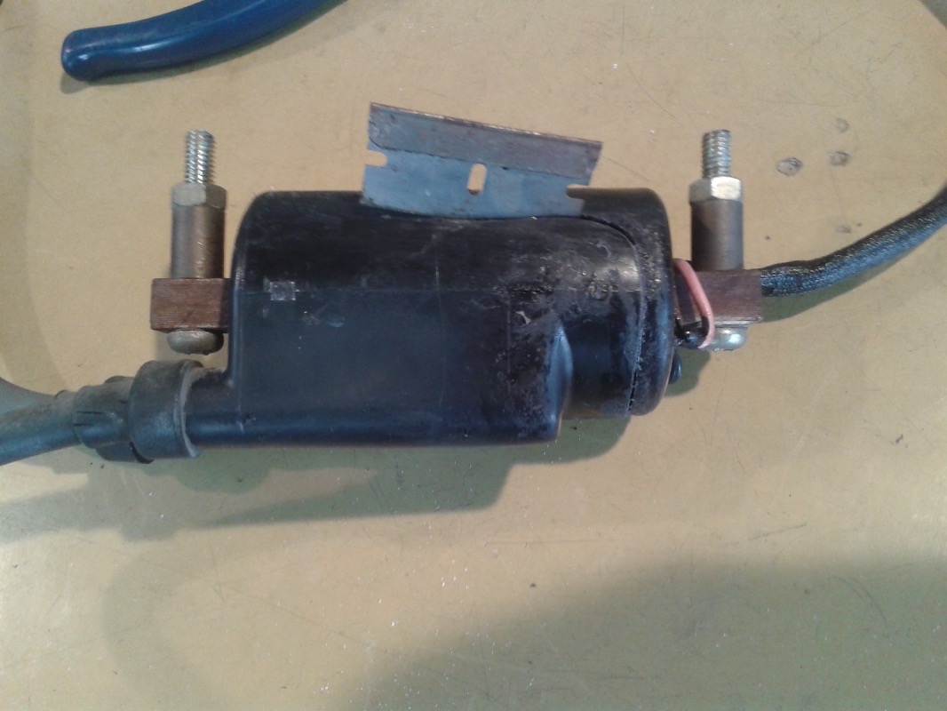

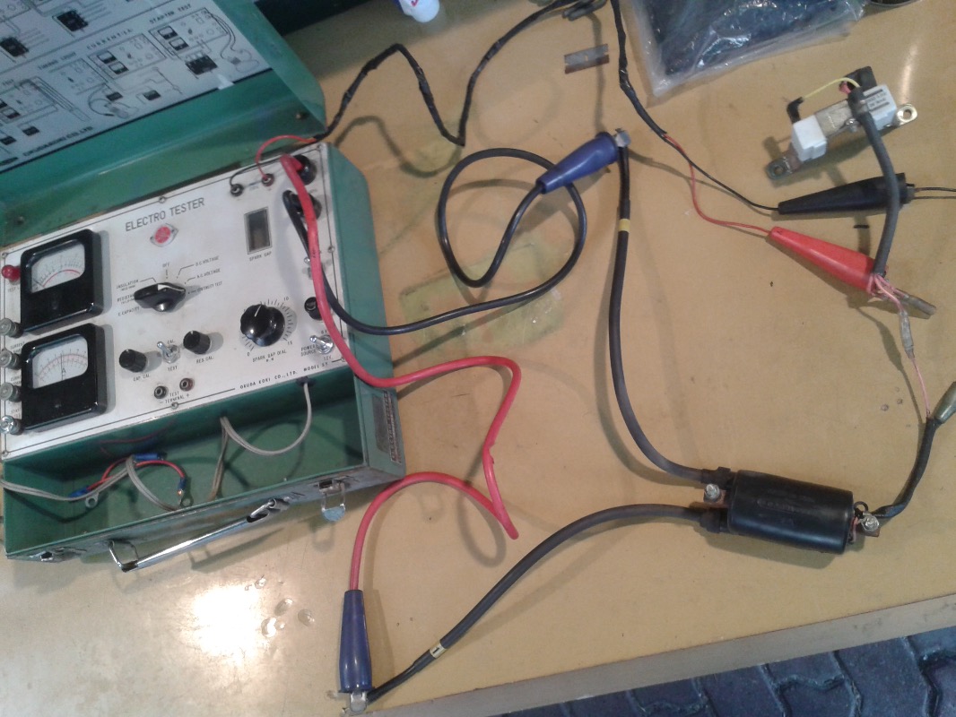

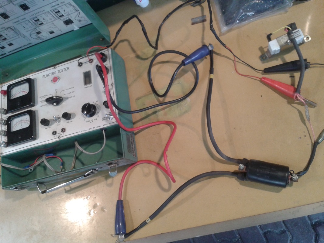

I took apart the coils and found that two of them developed a big crack, so big that you can actually see the coil inside, I used epoxy to seal them back and then tested them on my old Yamaha testing tool, they tested just fine, I tested the ballast resistor and IC Igniter, both passed as well. Every component was okay when it came to the bench test. I installed everything back on the bike, still no good. I was at a loss, then I found post #376
www.kz1300.com/index.php/forum/electrica...00-kz1300-how-to#376

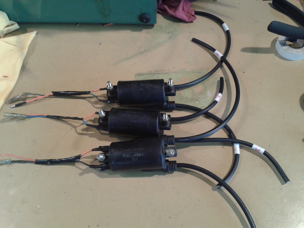

I also have a CBX and with it three spare AW82 coils, so convenient. I tested them and they show 2.6 ohms, good coils.

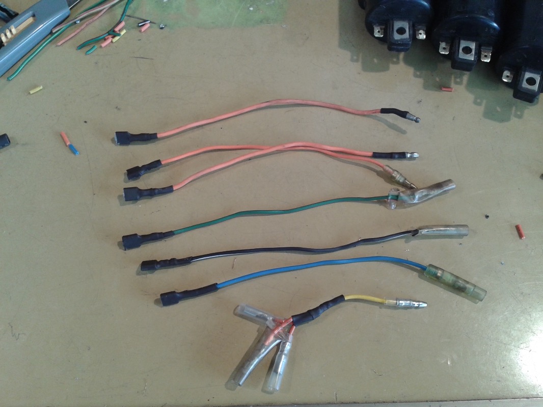

Followed the instructions and… presto, the bike started right up, I think it’s working better then it did before. I had to changed the tune on the carbs a bit, probably since the spark was much better now, and that was that.
Question, in that post I see that some people added a 0.4 ohms ballast resistor, should I do that, will not having the resistor damage the IC Igniter? I want to take the bike out for a test ride this weekend, just want to make sure it will not damage the IC Igniter.
Here is my update;

At 2.6 ohms you should be fine. If you were at 2.4 ohms like most AW82 coils, I'd say add.4 ohms resistance.
Adding resistance lowers the load on the igniter. The guide line is to maintain the primary resistance above 2.7 ohms. Thee are a few guys running 2.4 ohms without resistors and doing fine we here.

In the picture I don't see the screw on caps (that go over the spark plug wires). Do you have them?

I dont, these are spares for my CBX, i'm going to buy three more and make sure they have the caps, these are cheep...
By the way, I want to maintain the OEM look, can I use the HT wires from the original coils?
