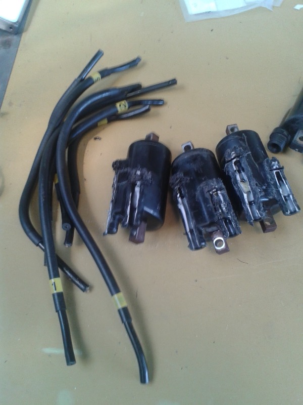

I also think you should be fine with 2.6 ohm coils without the ballast resistor. I fitted 2.2 ohm coils with 0.4 ohm ballasts and it all works great. My old coils also went the same way as yours with big cracks which I originally filled with epoxy. I found that the cracked coils generally worked OK until they got warm but produced a particularly poor spark on hot restart - compounded by additional heat soak from the engine and the lower voltage when the starter motor was turning. The new set up I have works like a dream!

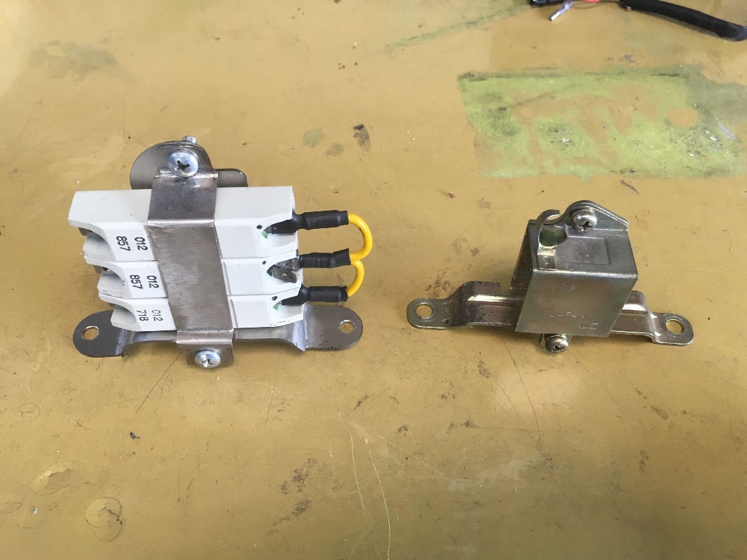

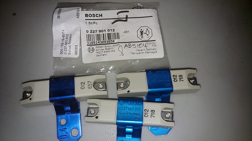

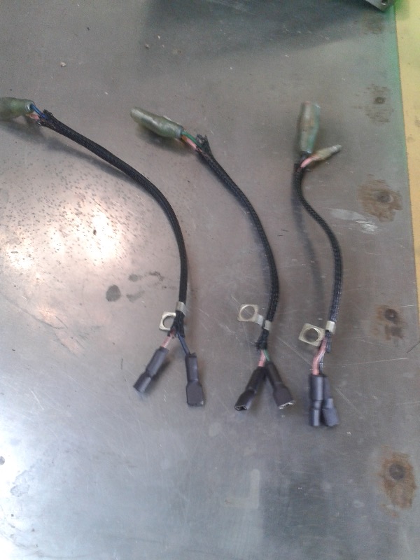

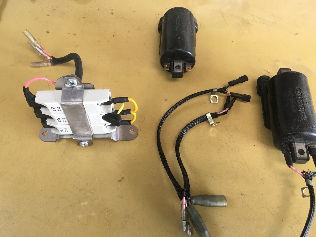

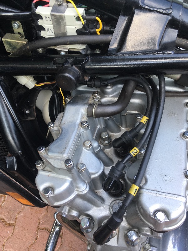

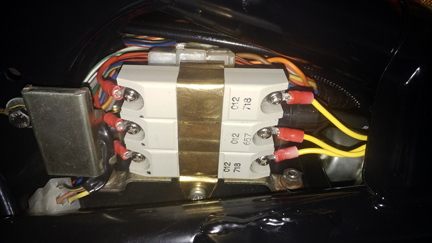

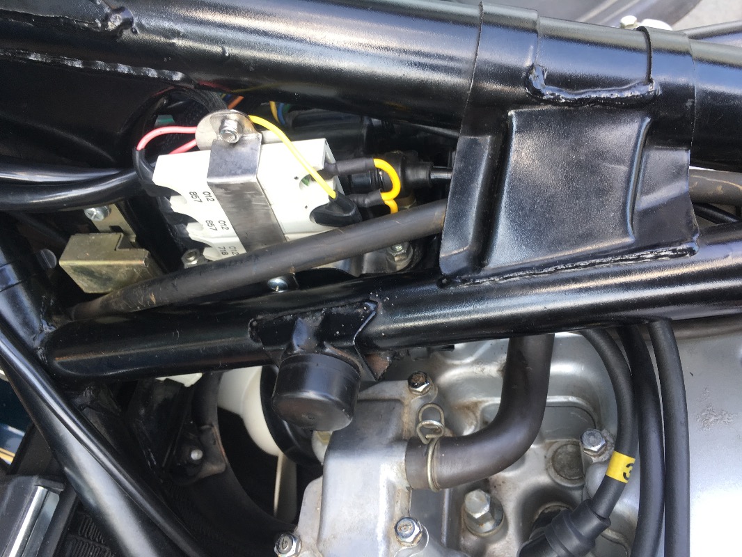

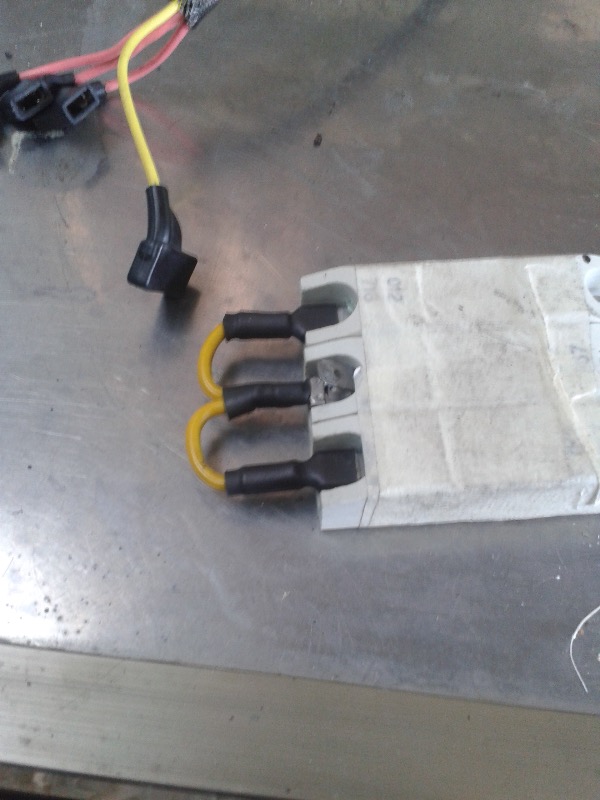

6 years 8 months ago #25044 by ronlander
Replied by ronlander on topic No spark on a KZ1300
I finally finished this upgrade/mod, I ordered the Bosch ballast 0.4 Ohms resistors (three of them), coupled with the Honda (TEC AW82TRI) 2.6 Ohms, made a mount for the ballast resistors so that it looks somewhat like the stock mount, repurposed all the wires, I wanted to keep the stock look as much as possible, reconnected everything and tested it. Bike starts up right a way and works much better then it did with the stock coils. Total cost for this mod was about $110, (coils, resistors, connectors)
