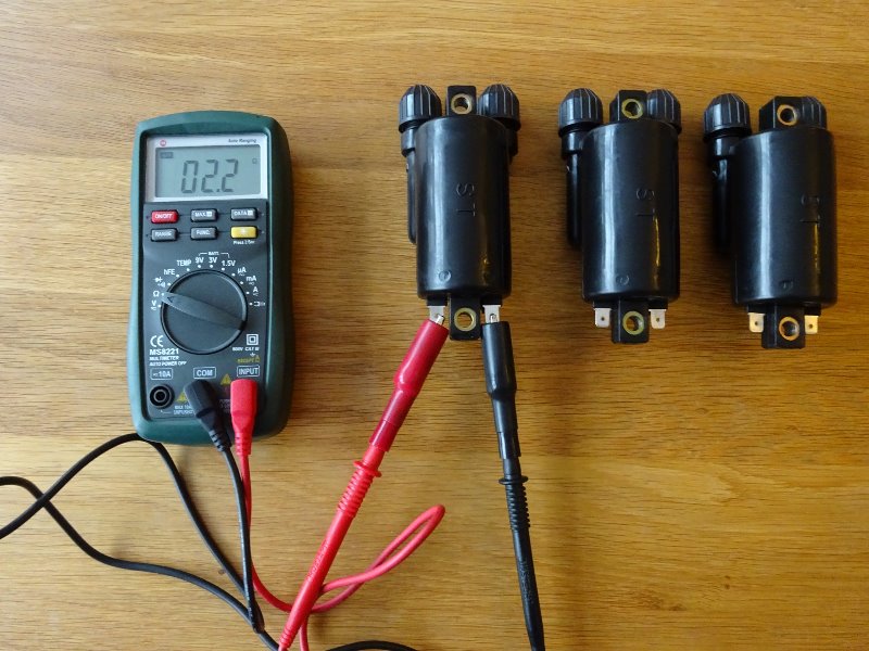

Having read through various threads on this site, I decided to avoid used coils (no guarantee they were any better quality than my originals). After confirming with MCG in Germany that their replacement coils were 2.4 to 2.6 Ohms, I ordered a set but when received these all indicated 2.2 Ohms (see pic).

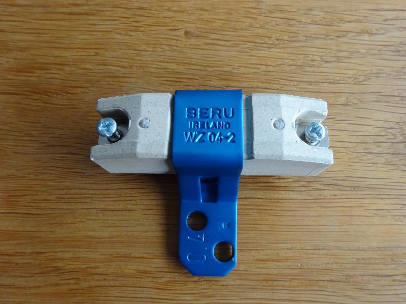

MCG said I should fit them anyway and they have sold many without issues. To be fair, the specs for the coils usually specify a +/- 10-12% variability in resistance so even at 2.2 Ohms they are theoretically still in spec for a 2.5 Ohm nominal resistance. However, having some respect for my ageing ignition unit, I sourced some 0.4 Ohm ballast resistors – these are specified for a number of cars for both ignition and diesel glowplug systems (see pic). These were about $25 each which was a little disappointing but I could not find anything else.

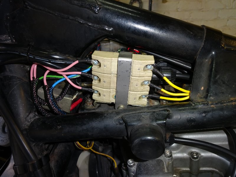

The next challenge was to fit these to the frame – combined together, they are larger than the stock ballast resistor. I used the original mounting bracket but slightly modified this to angle it down at the rear to increase clearance between the resistor bank and the tank. I also made up a stainless strap to hold them in place. I checked clearance with the "plastigauge" approach with some bluetack - its around 10-15mm which should be fine.
Wiring was relatively straightforward and the new coils, despite being slightly wider where the HT leads connect, bolt in place of the originals without modification
My A1 now runs extremely smoothly with a better idle quality and very crisp part load pick up even with “old” plugs. Hot start now also very reliable – always on first crank with just a touch of the start button. Hope this is helpful

Nice neat wiring job Neville !

You're one step ahead of me Neville. I bought the same aw82's and also the (in my case) .5 ohm resistors and they are Beru's. They do generate a fair amount of heat, so beware regarding the mounting position. I've pulled ballast resistors off of Chryslers back in the 70's and burnt my fingers. Frigging hot. The mechanic who worked in the next bay said" Why do you think the resistor is mounted in a ceramic base for??" They're just like the old stove elements back in the 1940's and 50's.
