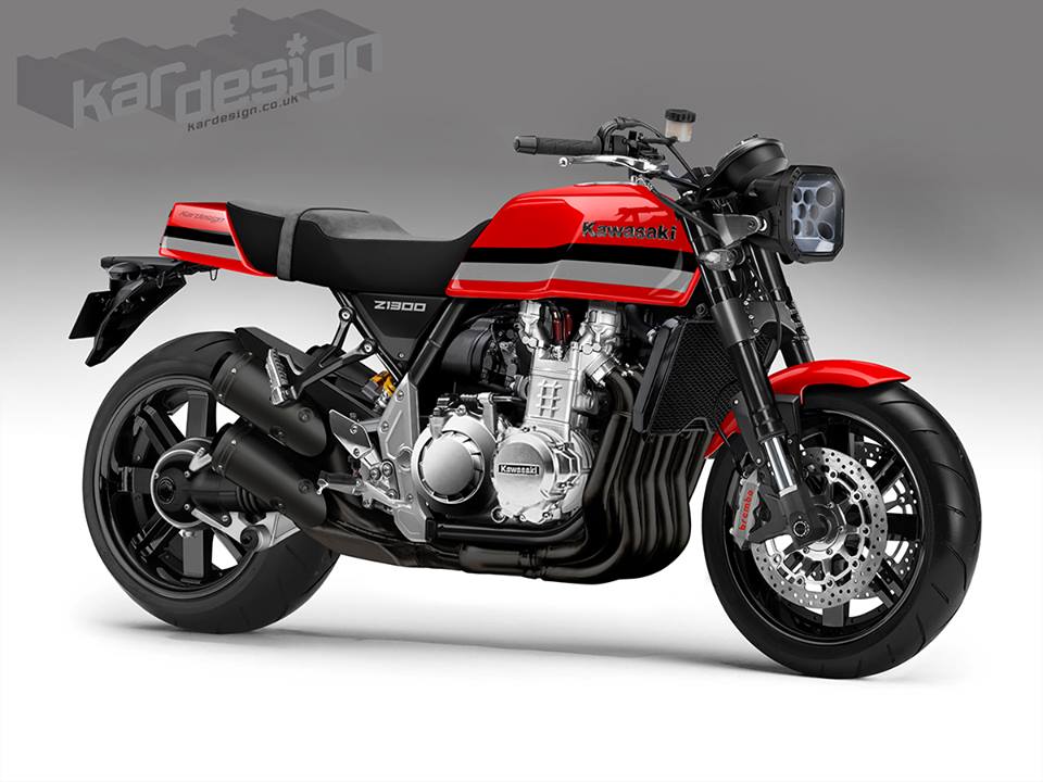

I have a brand new DG pipe in a box waiting to go on my beast BUT when I saw this pic
I knew I was going to have to build those pipes. Love the look and appreciate the design. 6 in to 2 in to 4. As far as exhaust design, the only more effective design would have been 6 in to 2 in to 1 I really wanted to spoof my KZ to appear to be a CBX but with a water cooled engine? Head turner. Then seeing this exhaust new I was going to have to build it.
Anyway, I digress. Looking forward to seeing your resolve here and I do appreciate your end goals as far as appearance. Quite unique. Kudos.

Quote: You could try packing with mineral wool (as an example Rock wool insulation batting material. I can tell you that insulating a room with fibreglass pink and insulating a room with rock wool, the room with the rock wool is silent compared to the same size room with the fibreglass pink. The rock wool is also fire proof to 1900 F. Unquote .... Rockwool, is that the stuff you put in the roof for heat insulation? I have a full roll of that still lying around... I might try that too.
And yes, I have seen that design a while back. I just wish Kawasaki would actually build it!
.... maybe that is and idea for the next build - take an old z1300 and build it to emulate that one... !!

That computer rendering above of the Z1300 was done by a fella called Kar Lee, he would do a modern make over for a different classic bike every month on a page titled "Retro Re-boot" in Classic Motorcycle Mechanics magazine here in the UK. They asked for suggestions on what bikes to do next so I Emailed him to ask if he'd do the Z1300 which he eventually did. Not saying it was completely down to me as there were probably multiple suggestions for the Z1300 lol.

I'll thank you for poking him to do it. It's awesome !! I just wish it was an overbore 4 valve per cylinder.
