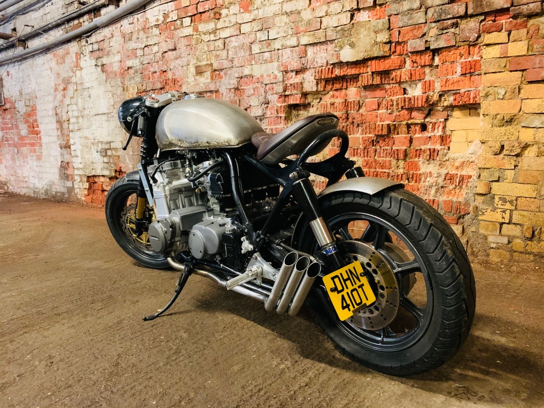

Hi chaps,
I have taken the beast for a longer ride last week and glad to report it goes well, apart from the hesitancy at low end, which I will be addressing with help from you under another thread.
However, even though the custom exhaust is killer, it is just a tad too loud for (my neighbours) comfort.
I got some baffles to drop in but they make hardly a difference by themselves, so I think I need to wrap these and then re-insert them. If you google/Amazon/Ebay 'exhaust packing' all you get is fibreglass wadding. ... not that keen tbh.
So I'd rather use (medium) steel wool for this, but I read this is highly flammable?
What is everyone else using (if anything beyond stock) and is fibreglass OK, or steel wool?

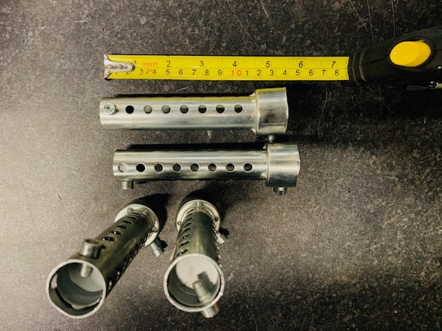

5 years 6 months ago - 5 years 6 months agoPhil wrote: Look up "Acousta-fil" on Ebay, it's sold in sheets & expands to fill voids when heated by the exhaust. And because it's made of long strand fibreglass it's less prone to blow out.
Or you could try this type that forces the sound through a set of baffles thereby muffling it, I have a pair for my MT-01 when MOT day comes round, they do a fair job of muffling. They do various diameters & lengths, I would've thought this shortest one would be enough to take the edge off the noise. Although you'll need 6 of them which won't be cheapEdit: Unable to post Ebay link, look up item no. 151293112591
I had those for my 1976 Harley sportster XLCH which had thru pipes and I also had them just for the MOT as I found they restricted performance a great deal.
I have found these - £26 for six.
They are 14cm long and on their own don't do much as there are just holes, no baffles, so they need wrapping. The rear bit can be adjusted to restrict it even more, but I'll leave it on the longest setting for now to let as much air though as possible.
I just wonder if performance will suffer ... and if it does, will I notice it??
I will go for the fibreglass option with steel zip ties and post pics and vids of the result - next week probably. Ill also need to drill holes for the retaining screws, and for that the rear wheel has to come out. I have to leave the pipes on as the three sections (down pipe, collector section, rear pipes) are apparently glued together...
Thanks for the advice all!
Paul
Six-Pot-Cafe in the making...
