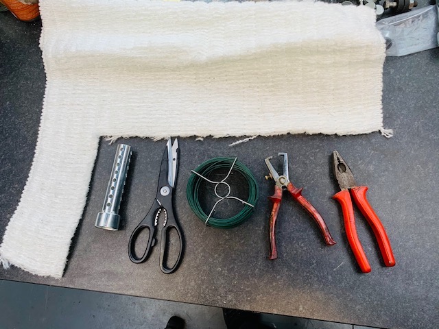

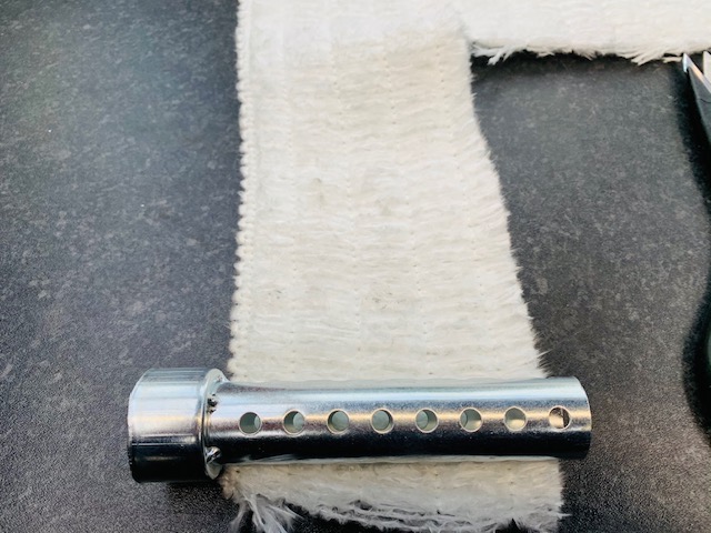

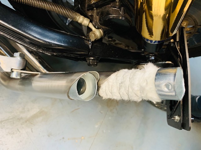

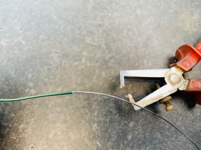

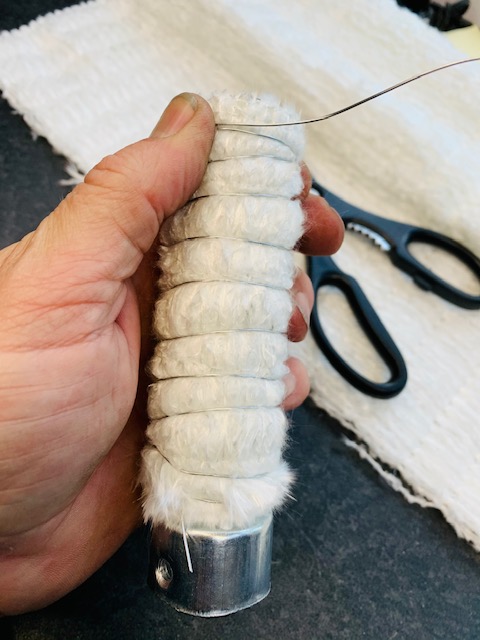

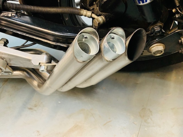

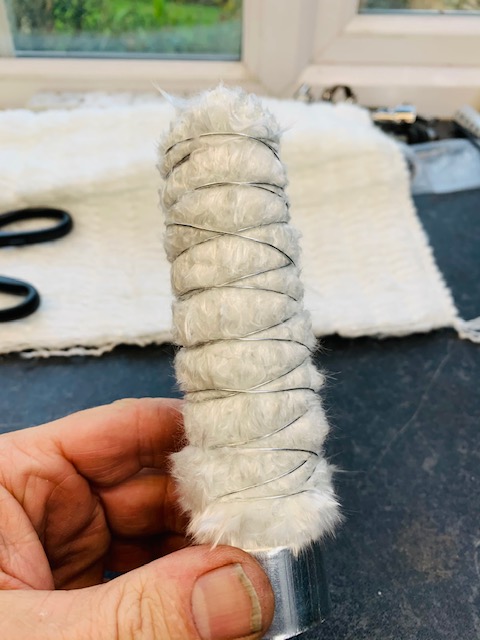

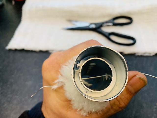

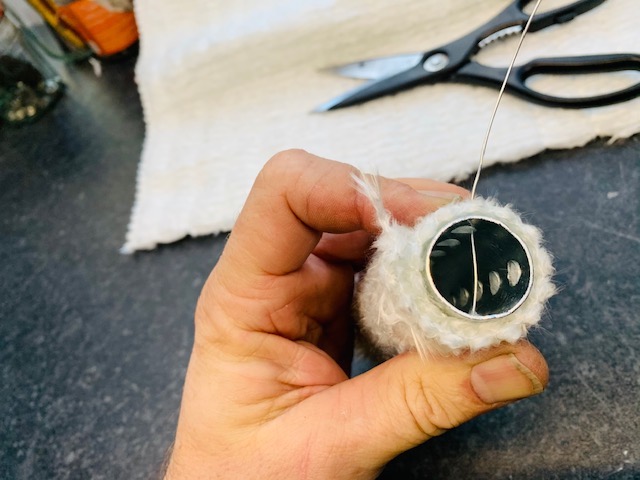

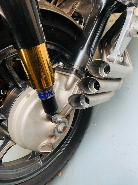

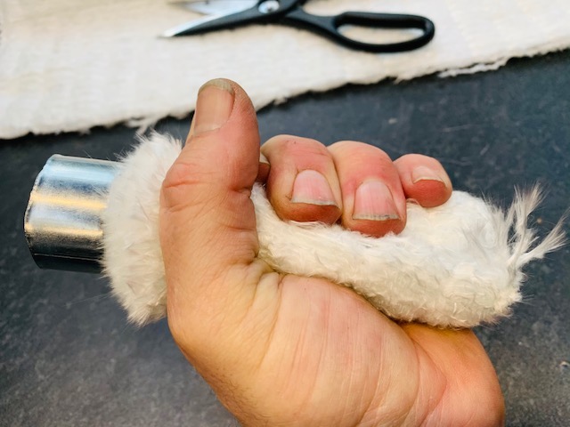

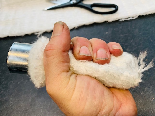

Well, I got all the required items through the post today and set about creating the mufflers with what I had.
Here pics on how I did it and a video link at the end to see/hear the result. I did not have to drill any holes as the fit was very tight and I had to hammer the tubes down to the right level. They ain't gonna come out by themselves I think, but I'll check over the next few miles..
I'm pretty chuffed with the result. Idle and low revs it now sounds deep and powerful, but not as 'cackingly' loud as before, and at speed its nice and loud. There is also no performance loss I'm happy to report (or none that I can notice, still running in and keeping it below 4000 revs).
So I'l leave it like this for now and see how I go.
Cheers all
Paul

Nicely done. They look very professional. I'll be curious to see if the packing rides up the baffles because of the lack of inner cone (the other half of the dog bone.) But if the coppers pull you over for noise, you've got baffles in their face.

Glad it worked out, looks & sounds well
I reckon the Acousafil will expand to make them an even tighter fit
