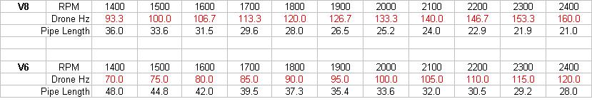

Kawboy, I'm currently having some Helmholtz resonators (or J-pipes) made for my car to eliminate drone after a free-er flowing exhaust was fitted, using this handy online calculator I found

The following user(s) said Thank You: McBoney

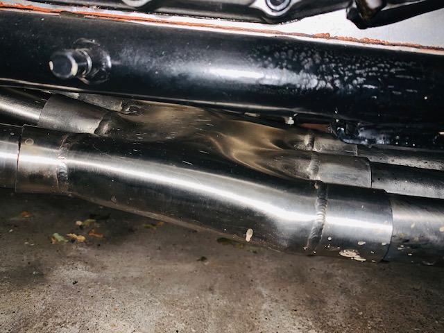

5 years 6 months agoKawboy wrote: First, you elected to run 6 individual pipes instead of merging say 123 together and 456 together which would have had a certain amount of natural cancelation pulses exiting the 2 pipes which would have been more homogenized, or merged all 6 into 1 would have created overlapping pulses with a certain amount of natural noise cancellation.
KB
Nope, 123 go together into a collector and 456 go into another one, then from there three come out each side making in LOOK like it is six-into-six (I am so glad I got you fooled - exactly the effect I was looking for haha!). Colin went as far as calculating the volume of the original collector boxes to make sure there was enough 'room' for the sounds to cancel each other out. ... not sure if that worked... I did ask for him to put one or two baffles in there, but he didn't.
If it is loud when riding I'm not too bothered about, its the idling and pulling away that my neighbour don't like, so thats what I want to reduce.
