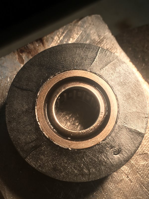

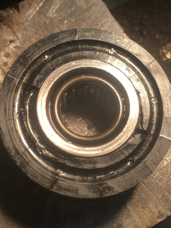

Has anyone found a replacement/alternative part for the C.C.T. rubber-roller? Mine looked great until I discovered radial cracks on both sides.

RE: Cam chain roller Thanks to kawboy for getting this rolling
"Gordon" has indicated that he can make a roller using "plastic". It sounds like this would be a "one of" for $60.00 us.
The bearings used in the sprocket and roller are "J-78", readily available - I purchased one for $7.00, locally and am currently "smashing eggs" !
I've mocked-up a two rollers - 1 nylon and one rubber. Still playing with these.
I took my cyl-block, head, pistons and valves to a machine shop last week. They are busy. Am expecting a call in a few days to let me know how things measured-up.
I'm prepared to buy new pistons/rings if required. +0.5mm and +1.0mm are available. I'm not interested in a Big Bore kit although it's ironic that a B.B. kit is cheaper.
I 've had some discussion with 2 trusted people about using a ball-bearing in place of the roller.
The specific size is hard to find but I did finally get a bearing #. 11 mm bore is NOT common. none-the-less - The consensus is "No". I'll leave it that !
