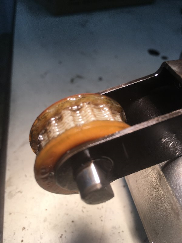

I received an email from Liska Racing (Gordon) in response to my CCT Roller query. His site (if you scroll-down enough) shows an OEM roller.
From Gordon : Correct. That part number is no longer available. I would have to see what that guide looks like.
I asked how he would fashion one: "Yes I would press a bearing into it. It would look like the KZ650 roller I sent you a picture of. Metal hub with a plastic outer ring bolted in between".
The OEM Rubber wheel is Bonded to the bearing shell. "Vulcanized" in a mould. No amount of "egg-smashing" can reproduce this procedure. This is the hurdle to over-come.
If this is the case - I can make it...... but first must exhaust options using a J-78 bearing.

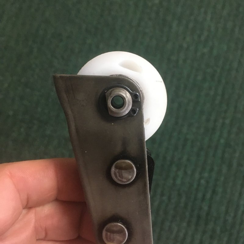

This is from other Kawasaki's
This is what Gordon would make

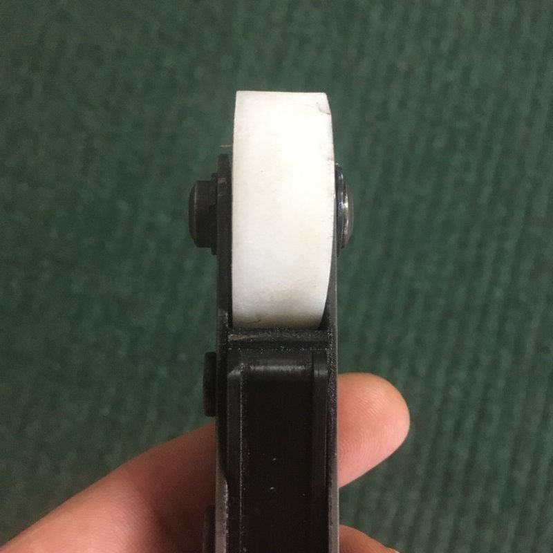

This my mock-up using Nylon

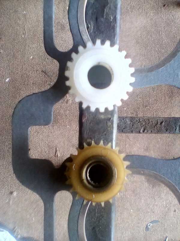

This is a new tensioning sprocket from Kawasaki purchased 4 years ago
It's a nylon sprocket and it would have a J78 bearing press fitted in to it directly, so I see no reason why a Nylon or Delrin tensioning roller couldn't be made up in a similar manner provided the correct interference was maintained. My only concern would be lateral tracking due to a loose chain if the chain tensioner was a manual tensioner and not spring loaded. So bearing that in mind, I would probably machine a couple of vee shoulders on the outboard edges just to ensure that tracking was accounted for.
This is the KZ1000 tensioning roller I believe.
It's a nitrile roller vulcanized on to a steel? bushing. As I remember it, the roller is 46mm in diameter and the bushing is 13mm ID. so if the bushing could be machined out to the od. of the J78 bearing less .002" and a J78 bearing pressed in, then machine down the od. of the nitrile to 35mm, we'd be in the money. I can envision clamping the roller down to a drill press table and drilling/reaming out the bore. It would be delicate but doable. and machining down the roller diameter while locating around the bearing. All doable but definitely time consuming.

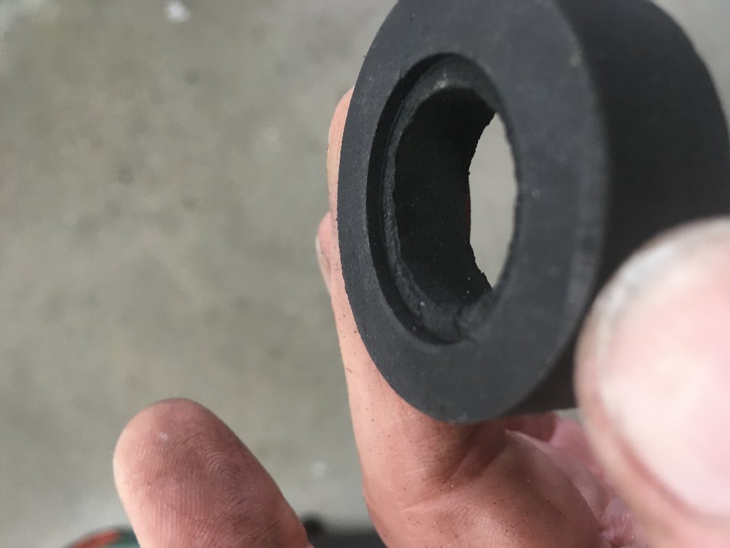

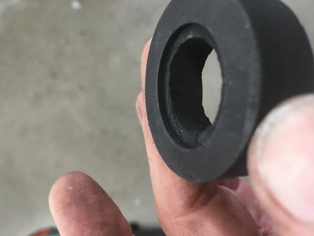

I settled on this: The core is my OEM Sprocket
Ended up with a suitable rubber wheel, after 3 "prototypes"
Used JB Weld Pro epoxy to bond the two.

Looks great !! Let the testing begin.

I'm as confident with this roller as I could or would be with any aftermarket product.

1. Regarding the use of epoxy adhesive to bond the rubber to the plastic sprocket centre. I've never had lasting results when using epoxy on rubber or plastic. I was just contemplating the consequences of failure. Presumably, you have confidence.
2. Is that new rubber of sufficient hardness, heat and oil resistance ?

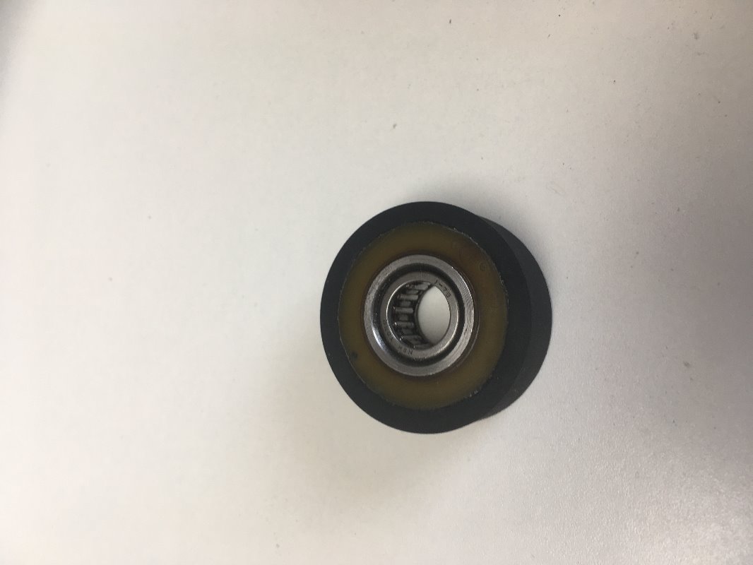

Could this roller be used, with adaptation? It already has a needle roller bearing, so assuming it is a J78 , the roller would just need the profile flattening off. Not sure about the width though.
www.cybike.co.uk/Shop/Products/all-produ...places-oem-12048-001
