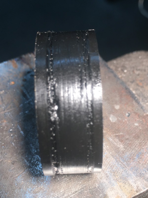

kawboy: I initially had some concerns about chain drift but have dismissed it. The 3 chain-guides look new ! The original rubber roller had worn into the center of the tire about .5mm. The approx. 1mm shoulder on each side had virtually no marks of any kind, indication no chain drift.
Sorry 'bout the crappy picture. This is the one that I should have deleted !
I just ordered one of the vintage rollers. 2 weeks if I'm lucky ! That's $100.00cdn incl. shipping, so far. Machine shop $ - ?

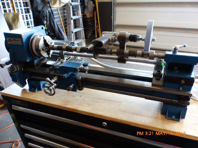

A lathe - how I envy you Kawboy. What make / type / size is it please?

It's just a little 7"x24" atlas lathe. I have it mounted on a tool box. Here's a pic of it with a camshaft chucked up and one of my many attempts at tooling up to grind camshaft profiles. It's a cute little $400 experiment. It has a carriage feed that's adjustable by changing out various gears. When I got it, I just wanted one big enough to play on and not take up too much space in the shop. Just something to doink around on.
