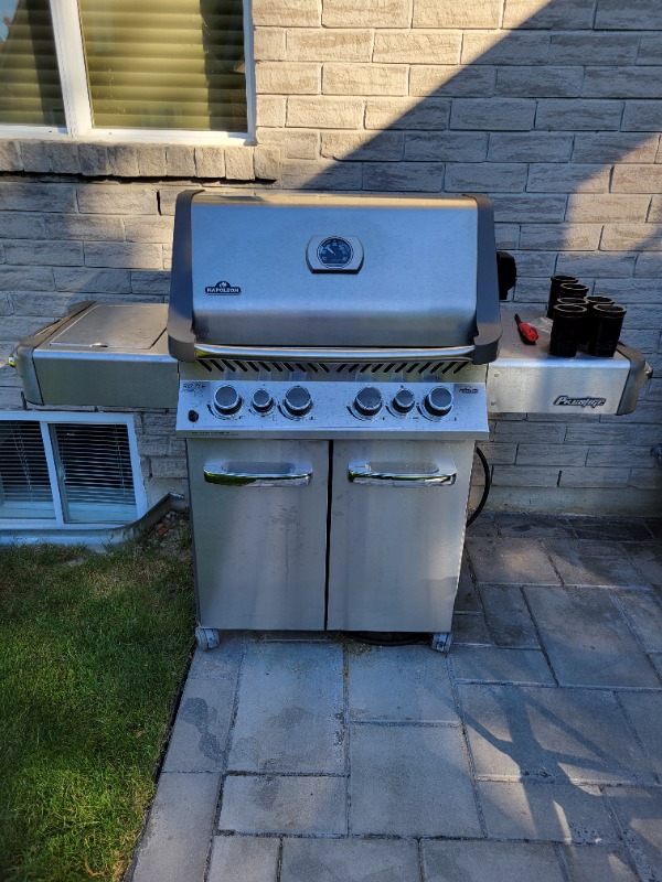

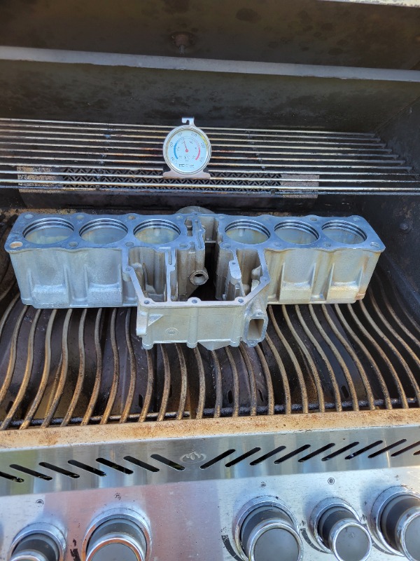

Up here in Canada, if it's not raining, it\s BBQ season. Today, we have the Cylinder Block warming up for the sleeve installation. Lower O-rings lubed up with silicone grease and installed in the grooves in the block. Placed upside down on the grill and heated to 300F. for one hour to heat soak.

BBQ at 300F with the sleeves off to one side.
Cylinder block "on the grill" and as an insurance I used a baking thermometer to double check the temperature

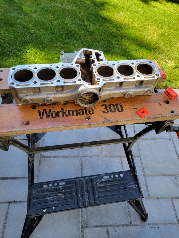

Cylinder block on the Workmate with all the sleeves installed. Took less than 2 minutes to install the sleeves.
