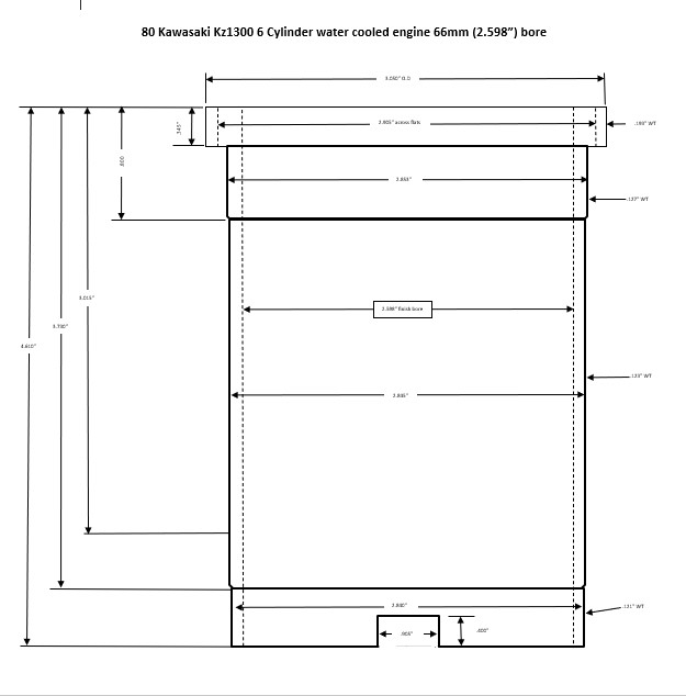

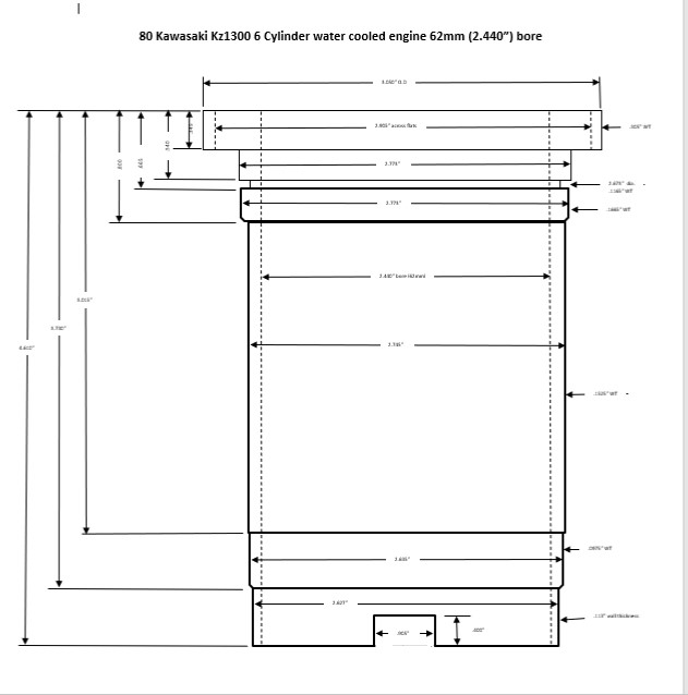

Here's where I'm at.
This is a drawing I created of the stock cylinder sleeve.
This is a drawing of a proposed sleeve for a 66mm big bore. It would require boring out the cylinder block top and bottom. No o ring groove on the top which means the head gasket is now the sealing point between the water jacket, the cylinder block and the cylinder head. This is a similar practice to what happens when Darton Wet Sleeves are installed. I still need to add o ring grooves (2) to the bottom of the sleeve for sealing the sleeve to the cylinder block. Just need to check and see if I can do this with .070" Nitrile o rings.
Just thought I'd put this out there for thoughts. Gert Roewer has done 67mm big bores (10 of them) and even a 70mm big bore using offset cylinders but that's too wild for me. I now have 8 KZ750 pistons which have cost me $35 CDN so I'm exploring thinking that I could have bought 64mm Cruzin Image pistons at $250 USD ($350 CDN) or invest in custom cylinder liners . 64mm pistons get you to 1370 cc. 66 mm get you to 1457 cc's

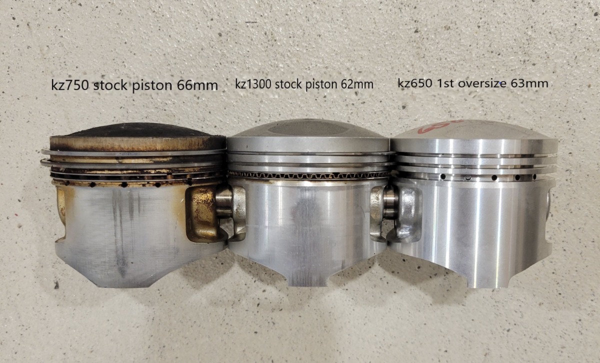

Reading this about the piston pin I've been told that it's 16mm not 15mm ?? I don't have a 1300 piston to hand yet.
- Kawboy
- Posts: 3243
- Thanks: 1198
Re: Cylinder sleeve removal / replacement
2 years 5 months ago - 2 years 5 months agoThe KZ650 pistons are identical to the KZ1300 pistons in all respects, including bore diameter. (62mm)Reading this about the piston pin I've been told that it's 16mm not 15mm ?? I don't have a 1300 piston to hand yet.
The KZ750 spectre pistons are identical in all respects except are 66mm in diameter. Interesting note that there are an addition 6 oil drain back holes below the oil scraper ring plus the same 6 holes behind the oil scraper ring
All 3 pistons, 62mm KZ1300, the KZ650 and the KZ750 pistons all use the 15mm wrist pin.
You can see in the picture where I used 2 wrist pins and inserted in the 3 pistons in order to compare the crowns of the 3 pistons for height and curvature. The valve pockets are really close and I suspect the only way to determine use of a different piston would be to assemble the engine and do a clay impression between the valves and the piston crown to determine if some minor machining of the piston crown needed to be done
