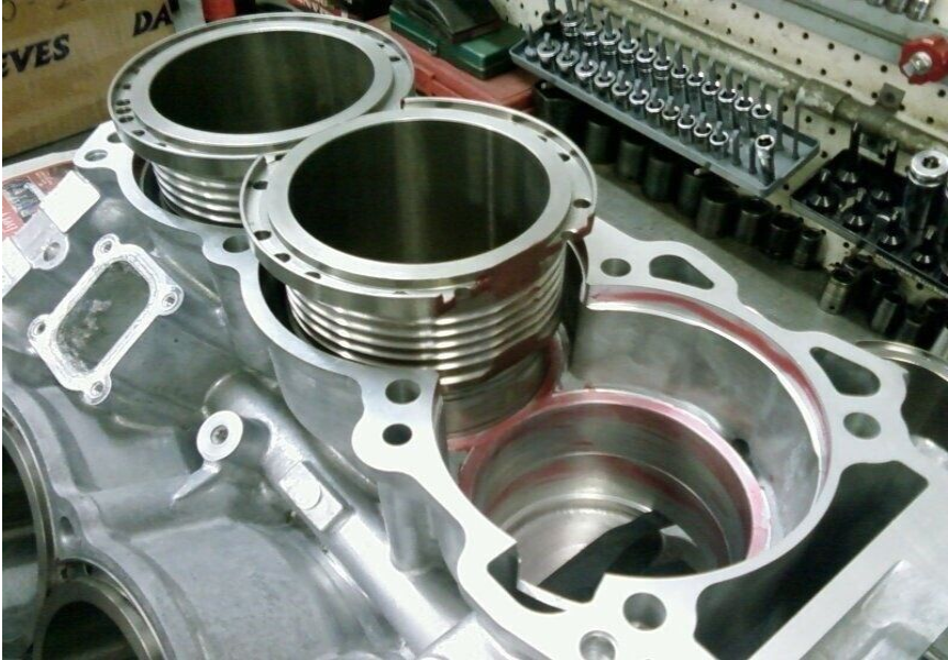

Never say never. I want to talk to a machine shop about oversize liners with no o ring on the top groove. I see lots of mods done where the web between the cylinders is removes and the sealing of the water jacket at the top is accomplished with the head gasket.
There's 2 - .103 thick Nitrile o rings at the bottom, and I wonder why 2. Were they thinking they needed one to seal the crankcase oil from the upper o ring that was sealing the coolant?
The O ring at the top was a .080" thick Nitrile or maybe NPR o ring and they were heat deformed and flat on the OD and round on the ID. The gasket kits come with silicone o rings for the top groove and silicone has a higher heat resistance (better)
Lots of pics on the Darton Sleeve website showing highly modified cylinder blocks where the cut out the cast in place liners and machined for big bore wet sleeve liners and it's obvious that there are no o rings at the top of the liner.
This is a small block Ford engine. Note that there's no web between the cylinder bores

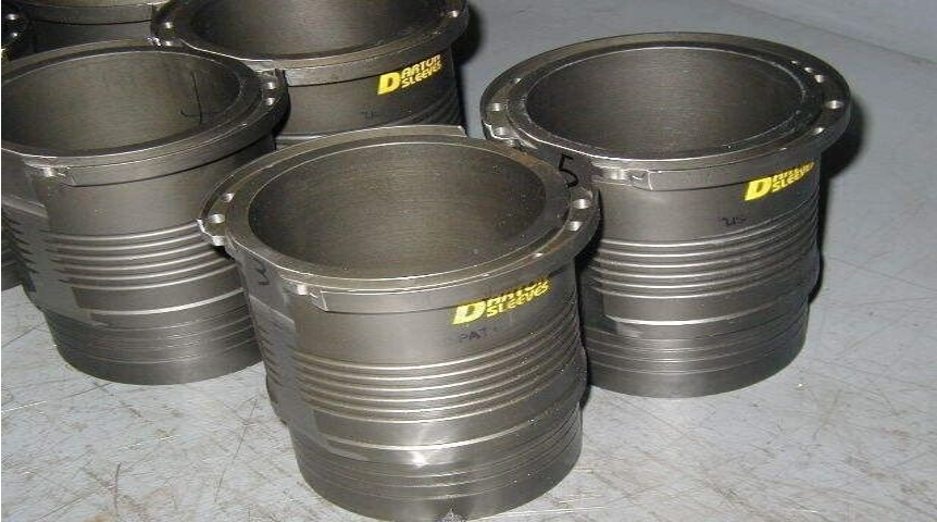

This is the sleeve for the above engine. Note there are no o ring grooves on the sleeve at all. They must use some kind of liquid sealer at the bottom. RTV silicone?? Worth investigating.
Oops !! Just found out that there are 3 very small diameter o rings at the bottom of the sleeve. (.070" dia. maybe??) Still investigating.
