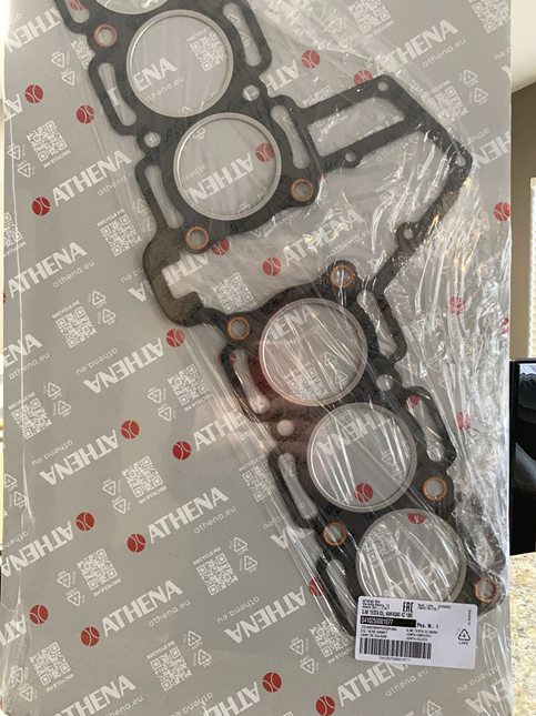

Brixamoto sells head gaskets made by ATHENA
The irony ?
