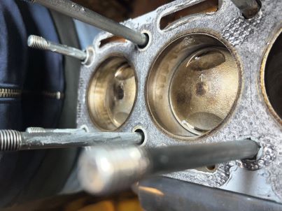

Hi Kawboy. Stem seals just fine. I have been checking all the valves, by the book. They all seem to be within tolerance ! but doing the wobble check. On a few of them not good. you can see the play.
At this time, I've just ordered a micro bore gauge for the guides.
When the bike was running i did this with only the bottom part of the air box fitted. Yes a large amount of oily smoke from here.
Can you remember a post from last year, when the head had been re-built I then checked bore pressures. You said 175 psi was too much !!! Well if too much was present in the bores. Surely this would cause this.
Getting back to the present ! if you look at #6 on the previous picture, the exhaust valve has started to crack. Both valves on this cylinder were changed for new ones. Purchased from a Kawasaki specialist !

3 months 4 weeks ago - 3 months 4 weeks agoHi Kawboy. Stem seals just fine. I have been checking all the valves, by the book. They all seem to be within tolerance ! but doing the wobble check. On a few of them not good. you can see the play. You'll need to change out the guides. Almost no point measuring the guides if the valve stems are within spec and the wobble test is out of spec. think of the valve stem as the "measuring tool" and you already know that size.
When the bike was running i did this with only the bottom part of the air box fitted. Yes a large amount of oily smoke from here. That's all I need to hear. Cylinder bores out of spec and piston rings not sealing either becaue they are out of round or the ring end gaps are too big. When fitting rings to bores, one should aim for the smaller size of the accepted spec, knowing that as they wear, the gaps will get bigger. In the case of aftermarket rings, you have to fit according to the ring manufacturers spec, not the Kawasaki manual spec. Ring material expansion varies based on material.
Can you remember a post from last year, when the head had been re-built I then checked bore pressures. You said 175 psi was too much !!! Well if too much was present in the bores. Surely this would cause this. Yes, 175 is too much but this only may cause detonation / preignition which is not good. The pressure in the combustion chamber after ignition can rise to as much as 400 psi and that pressure is what to focus on.
A typical 5.0 L v8 at idle will exhaust about as much smoke out the PCV syystem as a lit cigarette sitting in an ashtray on a new broke in engine.
Getting back to the present ! if you look at #6 on the previous picture, the exhaust valve has started to crack. Both valves on this cylinder were changed for new ones. Purchased from a Kawasaki specialist ! Too bad. Sorry to hear that.
I also see (maybe) the contour of the intake valve appears to be different than the other intakes??? Looks like a conical tit rising into the combustion chamber ??

Hi Kawboy, OK at this time I have some photos to downsize, so it will enable me to post them on here. Have been measuring valve stems, as said before. Wobble tests done, about 4 of the exhausts look to be very close to maximum and probably over the limit. Just waiting for my micro bore gauge to arrive.
Now for what i will be posting in the photos ! the cylinders are still in place. So with a friend helping me, we still have oil in the sump its reading the lower mark in the oil sight glass. Obviously head removed.
Turning the engine over, that's my friend withe the crank nut. Me letting the cam chain running over my hands.
After about two turns, It became very obvious !!!! most of the cylinders were showing lot's of oil up the cylinder walls, As if the oil rings were stuck in ! worst were #1-2 as i said before lots of smoke from left hand exhaust.
So how much oil was being thrown up @ a few 1000 rpm ? Oval bores NO, I have measured front to back and side to side. But to be fair , not removed the cylinders yet.
Have you ever come across this before ? is it possible for the oil rings to be stuck. It seems to have got worse over the years. But as said before, the person who i got the bike off it was standing for many years.
