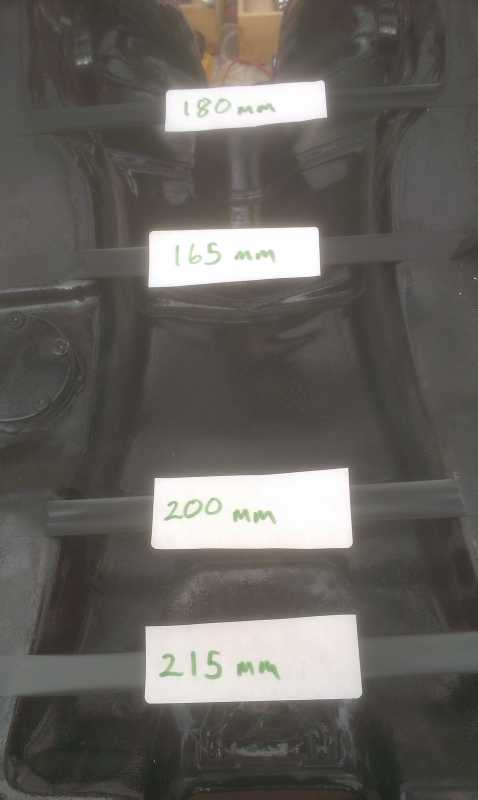

- charlie9670
- Elite Member
- Posts: 235
- Thanks: 11
Re: Fuel tank blues
9 years 9 months ago
Tried to get some measurements of the tunnel on my spare tank, not easy to measure accurately with an old tape so maybe not much help but I'll put it on anyway.

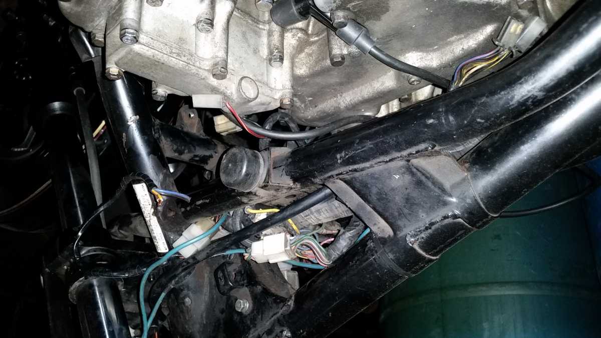

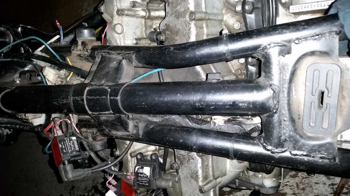

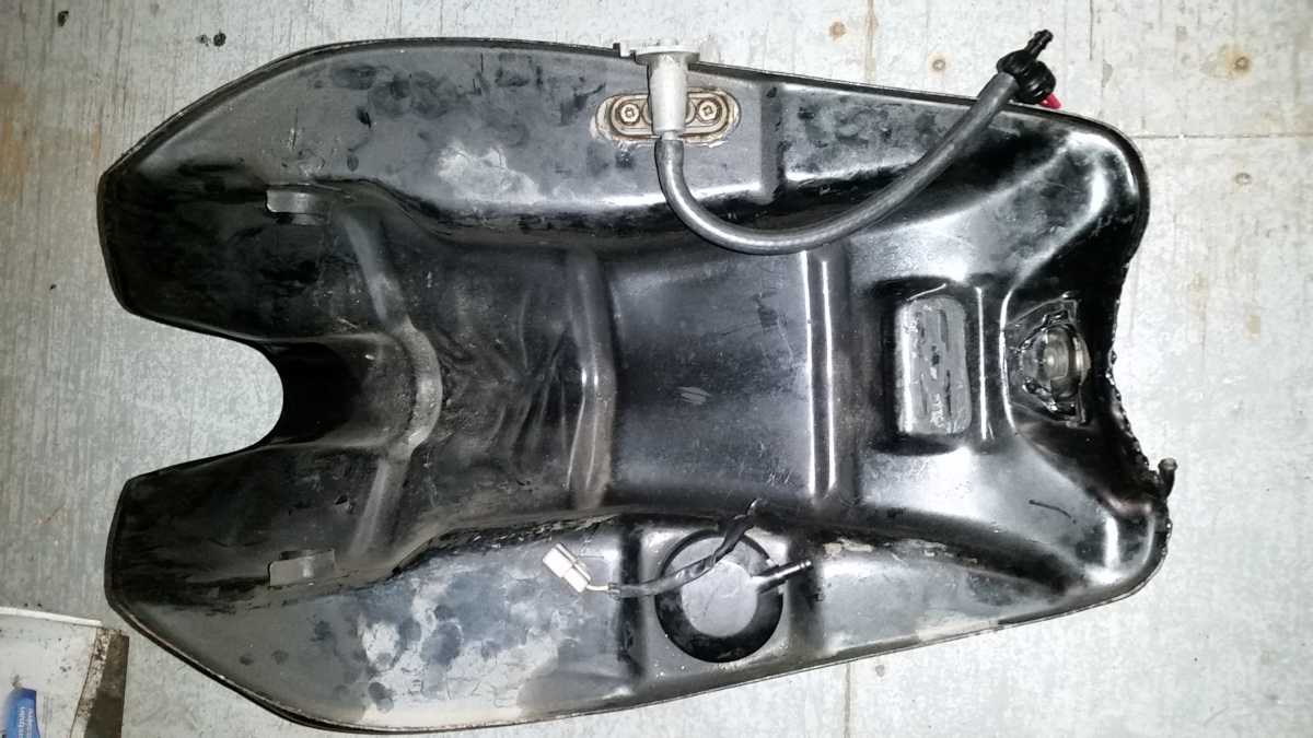

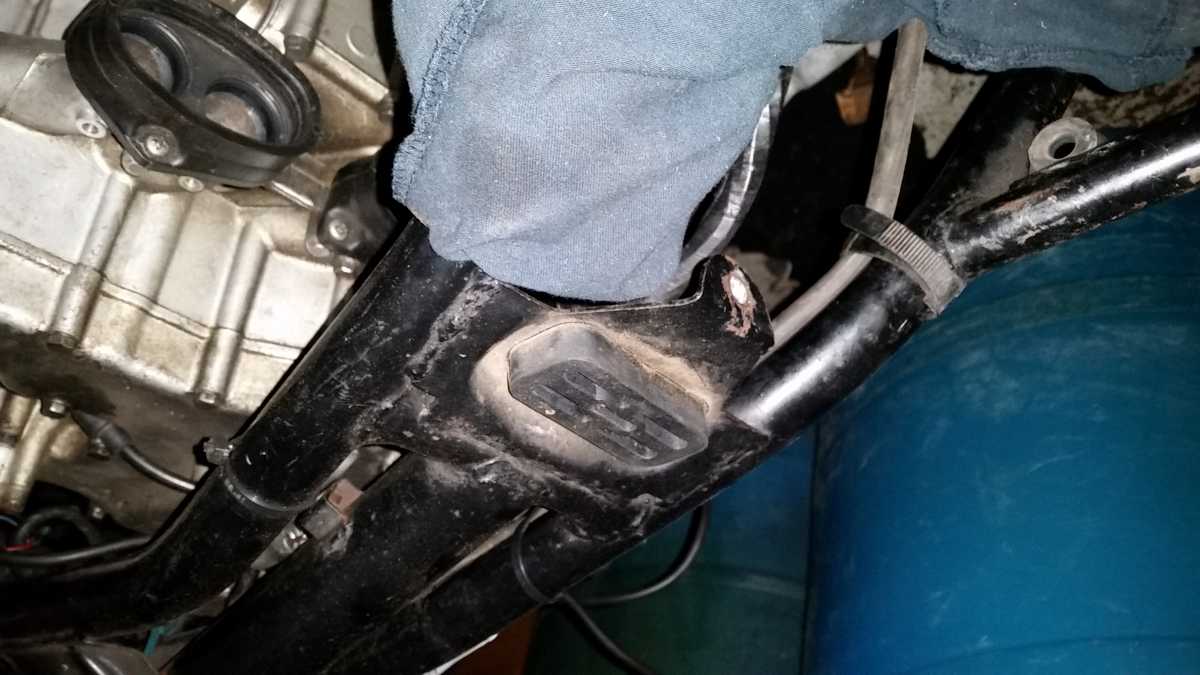

- Ledkz1300
- Posts: 627
- Thanks: 71
Re: Fuel tank blues
My 79 tank is full and has fresh paint so I can't flip that one over until its empty. Here are a few pictures of my 81 tank underside and frame for comparison.
