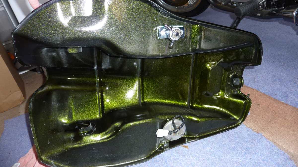

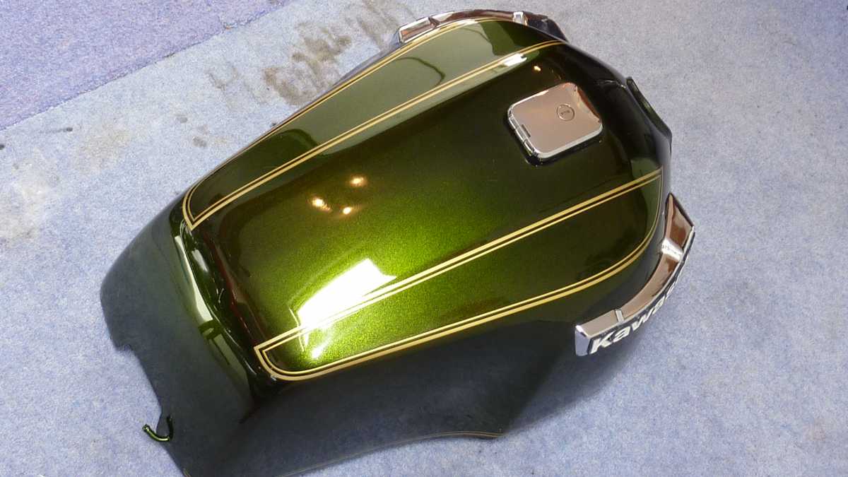

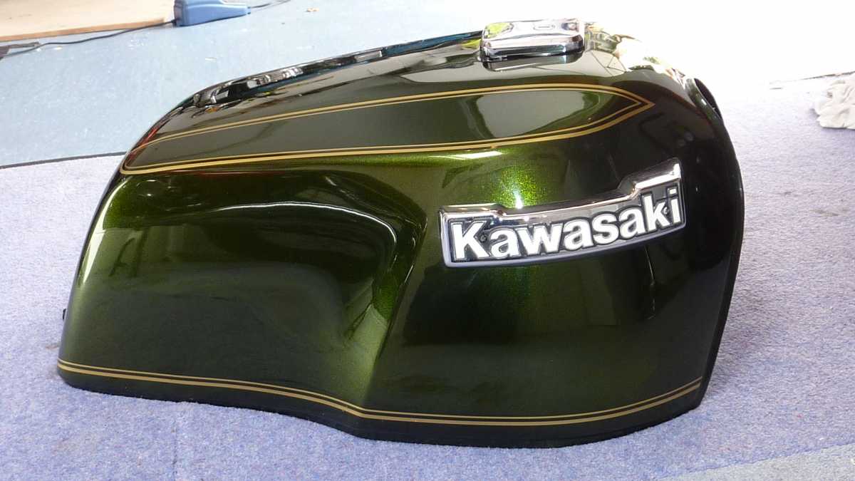

MZ, I currently have the tank off my 1979 A1, as my bike is yet again playing up and off the road (just in time for summer
I cant enlarge your pics to check the underside for any obstruction, but it looks normal - Ive added a few pics to you can compare your unit against.
Cheers Tim

What a beautiful tank, and the underside is indeed identical to my tank. Something along the frame is blocking proper installation. I will take another swing at it tonight and share later.

That's a KZ1300-B2 tank from the B2 Touring model. It will fit to any of the K/Z1300 carb models, the ZG (I think) injection models but there is no fuel pressure return. It wont fit the ZN1300 Voyager models
There should be a "U" shaped bracket on ether side of the inner panel with the open ends of the "U" facing forward. These slide onto the rubber mounts either side of the frame (there should be rubber caps about 30mm diameter on steel lugs about 15mm diameter either side of the frame) and then an allen head bolt with a big washer fastens just under the rear of the tank in front of the seat. I think there is normally some kind of grommet and metal guide in the back of the tank mounting point to act as a damper.

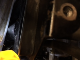

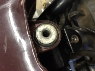

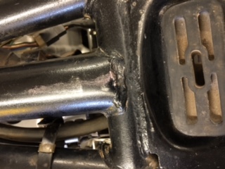

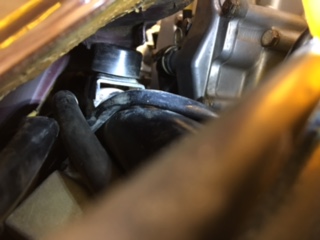

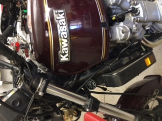

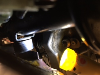

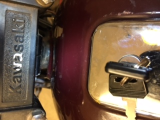

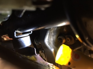

That hose was one of the first things we checked, but it is not the culprit. My Geometry teaching wife and I have tried repeatedly today to get the thing on, and it just won't fit. She took several pictures and asked that I post them and get suggestions from you guys. With the two rubber pucks near the 'U" cups under the tank, it seems the tank is too wide, sitting too close to the neck, and the last picture has a light shining where the bottom of the tank is rubbing the frame.
This is the tank that came with the bike. Many members have verified that this tank will fit. We are not super mechanics, but come on, taking off and putting on a gas tank? We have owned over one hundred motorcycles, and do all of our maintenance at home.
