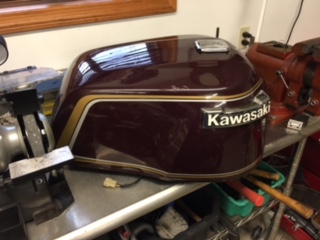

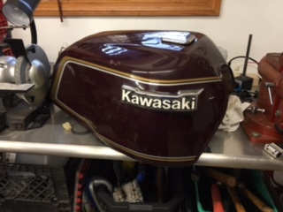

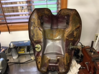

My problem is the fuel tank. The seller had the tank off when I bought it, which shouldn't be a problem, right? Well, I'll be hanged if I can get it back on there. I finally involve my wife, the math teacher (and pretty good mechanic) into things and she feels the underside of the tank does not align with the frame. Ah, Geometry.
Do I need an A model tank? Also, do I need a different (A instead of

if he had the tank off, is it the right tank ?? is it a voyager tank ??
stick a few pics up..

All of the KZ1300/Z1300 fuel tanks are a direct interchange. They just slide in place regardless of year or tank size. You do have to align the channels on the bottom of the tank with the 2 rubber mounting bumpers on the frame. Maybe it is not a KZ1300/Z1300 fuel tank, as indicated by kwak1261 in his post above.
