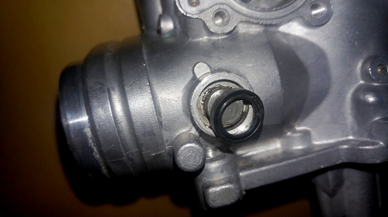

Regarding carburetors..... Is there a secret source of just the o-rings or do i need to buy them (if available) one by one? Or do I need to buy the whole repair kits?

Hello Stan,
You might like to read this page:
www.kz1300.com/index.php/forum/carburato...b-rebuild-kits#14837

I read threads about carburetors rebuilding but missed that part. Thank you Biltonjim! The 0-rings list is being made as we speak and I will be hitting that website ( theoringstore.com) soon.

Besides o-rings, these throttle shaft seals seem to have a different shape. I haven't counted them, but there are maybe 6 needed if dissembling all, but just 3 when doing the dead ends on each curb. What are their dimensions? Did you mention them Kawboy?
