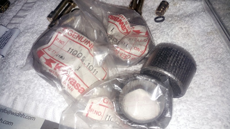

The piece you muffed up is called a float needle seat. The only part of that piece that really counts is the seat in the bottom of the needle seat where the needle seats and shut off the fuel. I'm sure you can clean up any light damage. Kawasaki calls this item a float valve assembly part # 16030-1005 www.partzilla.com/catalog/kawasaki/motor...-a3/carburetor-parts . Although Partzilla says the part is "no longer available" I would go to Kawasaki dealership and ask them to check including checking in the warehouse in Japan. They can do that. I managed to get camshaft tensioner nylon gears from the Japan warehouse. Took 3 weeks for the parts to show up, but I got them.

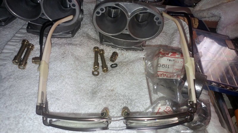

I will start with 'my precious' - two pairs of reading glasses so I can come closer to all the details which need to be inspected and polished.
