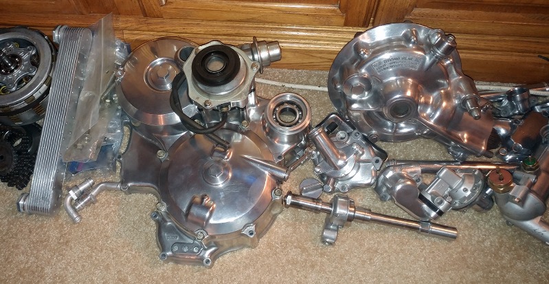

Now a teaser, just for some fun. It's KZ related by the 'polishing' factor, hahaha Last year I went through the extra parts for a Goldwing and some of them are in their full glory

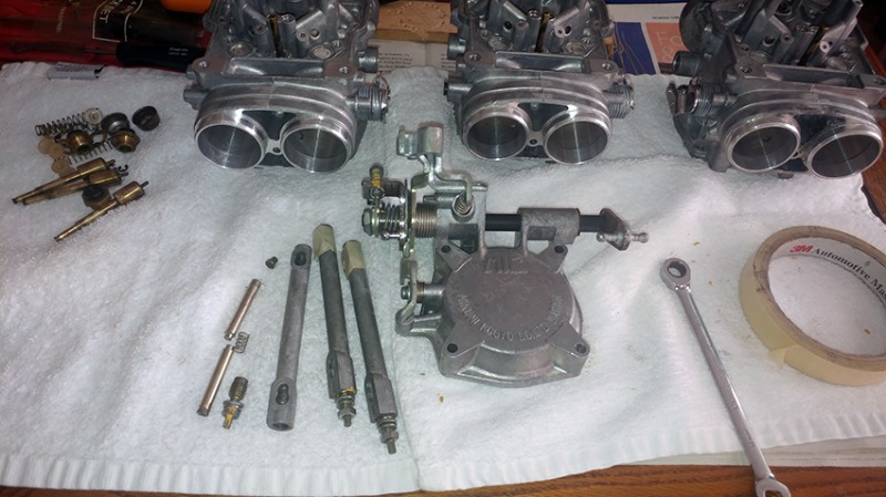

This is where I am right now:
I am not going to disassemble the center assembly linkage. The cover is clean and I will polish it a bit just to tease Kawboy, haha I know I can't remove the tiny discolorations, but you can't even see it on the bike. Looks kind of cool like made from marble. The metal ball joints at the ends of the throttle shaft are rusty, but some brushing and metal polish will take care if of it. I might spray at it some zinc rich coating, which will make them rust resistant and look silver at the same time. The springs and everything else look clean and shiny. All is tight and moves freely.

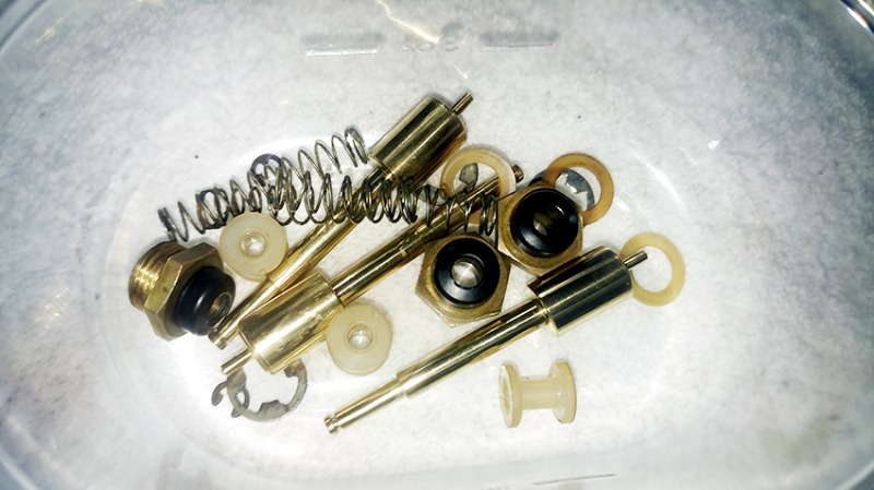

I can't move them at all right now. And those brass plungers - do you also remove them? I saw yours have those collars which you secured. Mine are just straight pipe.

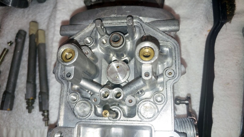

How do you remove that top grass piece which sits underneath the float?

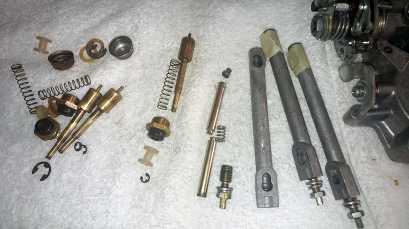

Not sure if anyone has mentioned this but just in case - those emulsion tubes seen in your pictures (with the keyway over the brass pin) - extract through the bore side of the of the carb - not through the bowl side (pictured).

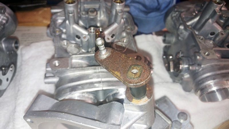

Stan. I'm looking at the pic of you linkages and am again compelled (lots of compelling this past week) to suggest you revisit your thoughts about leaving the main linkage shaft. Yes, the "Stacked" end must come apart but the '79 rebuild covers this Chinese-Puzzle . That heavy rust on the "ball-arm end" will wire-wheel off and with some of your profound elbow-grease, will polish (brighten-up) as will the other parts on the shaft. I know you'll polish the 3 link-rods!!!! For what it's worth I polish the internal parts too. I prefer to do everything I can to keep linkage drag to a minimum. The choke plungers should be polished lightly. No need to go crazy on these but a shiny stem and seal-end will allow the plungers to move freely with no drag, and this is important because the only thing keeping the choke-plunger seal against the seat is that one little spring (per choke). Wisely you've left the dust-cap on the plunger retaining nut !!!! Reading a bit further, you answered my Q about the diaphragms. Good to hear (by omission) that you're leaving the throttle-shaft seals, alone. The 2 steel throttle- shaft caps will polish.! A touch of wax now, and periodic cleaning will help keep the rust from returning on the steel pieces. The needle-valve bodies are giving your trouble? If after some soaking in a penetrating oil and some heat, they still won't budge - blow/wash out the P.-oil and soak that end of the carb-body (ONLY) in some lacquer-thinner. (Kawboy's laughing now - private joke!)

Regarding the 'stack' of springs, I will give it a second thought. But it is truly smooth and clean. There is no slightest indication of movement obstruction. Those rusted parts are already taken care of, except for finishing all up therefore not posting a photo yet. I used a small wire brush and left overnight in miraculous Metal Rescue. I can't see any rust left! Of course, a photo will follow later on.
Scotch, I admit the photo with the pliers confused me. I tried to pull those tubes out the wrong way! They felt solid so I left them to do more reading. Now I understand what you meant by not using the pliers! And thank you for the reminder zed_thirteen! I will give them a chance today in the right direction.
