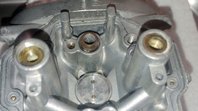

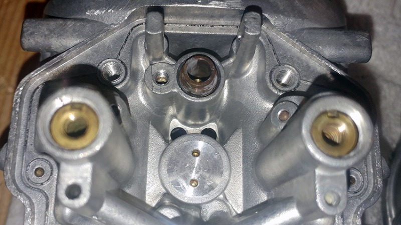

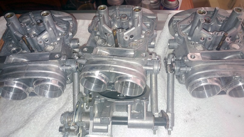

The carburetors after preliminary cleaning. Next I will remove all the little bits and give it another ultrasonic bath.
Could someone, (probably Scotch while drinking the morning cup of Java? haha), shed some light on this confusion?
All carbs have the same notched needle jets (I think that's what they are), like in this photo. They also are at some depth from the ridge of the carburetor's body.
Now, in this photo one of them, on the right, is solid all the way around, and sitting leveled with the edge. What's going on here?

Regarding your pics of the carb bodies and "what's going on here?"
The main jets screw into the the emulsion tubes which are in the carb bodies and the main jet holds the emulsion tubes in place like a tee nut. You could look in the throtle bores and see the one on the left is raised higher in the throttle bore because the previous "mechanic" who had the carbs apart, didn't install the emmulsion tube correctly. They have a locating notch in them that engages with a pin in the carb body to locate them. You should be able to push those emmulsion tubes out to clean all of the port holes in the side of them. there's like 20 .015" holes in each of those tubes. If they are blocked with the white oxide like I see around the top of the tubes., the fuel rising up the tubes will not be delivered in droplets. Push the tubes up and out through the throttle throats and clean. Don't rely on your ultrasonic to clean them installed in the carb. It won't work.

I think the one "without the key" still has the brass washer on. They are a tight fit and I don't think this one has been removed yet.
