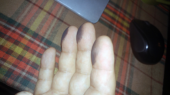

The surfaces were scraped down to aluminum and prepped with paint thinner and acetone. And scotch - they were NOT polished! haha
The info on the can (in a very fine print) says it's ok to touch after 1 hour, handled after 3 hours, and cures in 7 days. Then, it says it 'must' be heat cured for durability and chemical resistance. When doing off vehicle, bake at 250F for 30 minutes, cool for 30, bake at 400F for 30, cool for 30, bake at 600F for 30, cool 30 minutes.
I did my home heater heat treatment, which of course is nothing like doing it in a controlled environment. When handling some more of the block now, as I don't need to be careful around it anymore, there are durable areas which don't scratch. The other areas are just as bad as mentioned before. The last part doesn't go well with the 'safe to touch or handle' after certain time instruction. Check at my fingers in the photo below - I just simply picked it up. That doesn't look to me like 'safe to handle', so there is definitely a reason to write VHT.

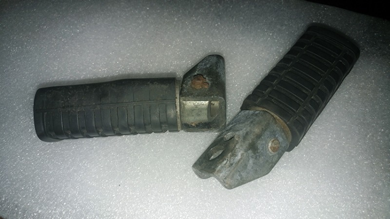

My parts list update:
I got these passenger pegs off eBay and forgot that they came with the mounting brackets! So this problem is solved
Just need to replace the cotter pins after cleaning everything.
