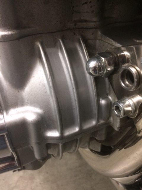

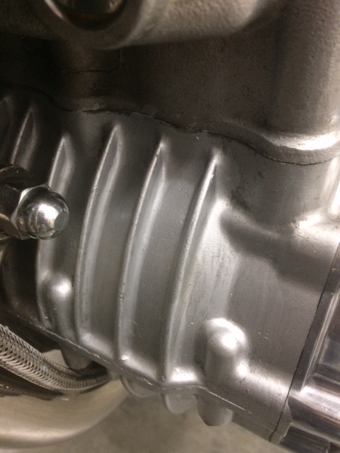

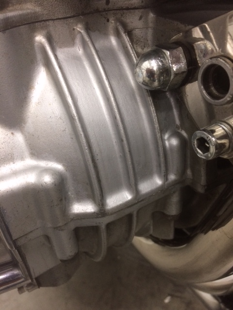

Biltonjim - I'm scratching off more of the paint off the cylinder block. Some areas are stronger, but that area in the previous photo just keep peeling off. My fingers are black just like if I was digging in a chimney. That's definitely not right. Overall, the surface looks more like covered in powder than anything else. Very weird. Kind of like if I dusted the whole thing with charcoal powder. It must come off.

Hey Stan - I have to agree with KB. Contact VHT ! Nothing to lose.
Going to play Devils Advocate here. So far I've never seen my engine oil temperature rise above 70c. Coolant temperatures remain within the operating range of the gauge. My point is - Why do we need paint rated at 500F? My cam cover was painted in Black-Wrinkle years ago. Even when the bike is HOT the paint is hard as rock.
One could debate the temperatures immediately behind the headers but I have this "gut" feeling that any quality paint, once cured, will remain intact, even in these areas. Naturally, surface preparation with general-use paint, would be no less critical then if using "rated" paints.
If the Paint you are using is not defective then there must be a conflict chemically between the paint and perhaps the cleaners used to prep. the surface. When I recently rebuilt my front calipers it took 4 full days in a warm shop for the "rattle-can" gloss black to cure enough to handle. The paint seems bullet-proof, now.
Hope this provides some potential for figuring out what went wrong.
This past weekend I touched-up some small chipped areas on the front of the engine cases. Used a 3/8" fine bristle artists paint-brush to apply Silver "Rust-Oleum" paint. The match is good. Had the areas been larger I would be putting a clear coat on top, but will leave as is with just the silver paint. Not suggesting this is "the' paint to use - just trying to stimulate the brain for alternative solutions and to perhaps resolve the problem by thinking sideways.:side:
Perfect? Hell no, but adequate for the intended result.

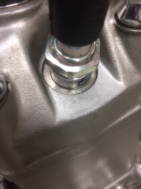

Hi Scotch,
What is that in the middle of your front engine mounting plate?

Re: front engine mount mystery part.
It's a flanged bushing that was intended for something that was later abandoned. I decided to leave it.
