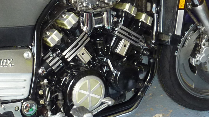

Stan,re paints: saw you said you were considering maybe going with a gloss finish ?
A year ago I re-painted my Vmax engine: the Vmax forum guru's recommended using a paint called Simoniz Engine Enamel - gloss black: meant to be near as dammit same as Yamaha original finish.
Sorry its not a great picture - but the only one I took.
Well, to my surprise they were not lying: the finish looked like poured glass and is heat resistent.
I rattle canned onto a clean but not perfect surface and was well impressed with the results - can recommend if you are looking for a one coat high shine gloss finish.
