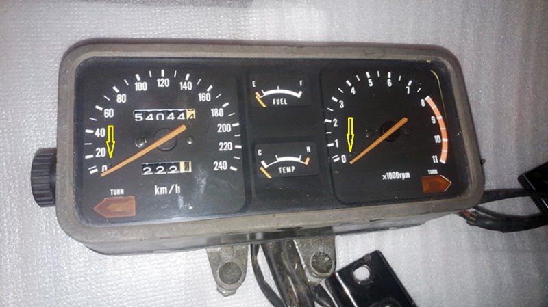

Hey Stan ! Regarding your new instrument cluster: (Nice find and a great price) - I enlarged your photo cuz something caught my eye. Is it some weird illusion or are both needles on the wrong side of the "0" stop-pins ?

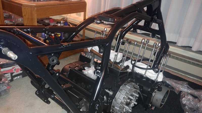

The powder coating is fantabulous. It looks even way better in person. The frame being the basis around which the bike is built, I'd say go for it and don't look back. Just like you told me all along! It was expensive overall, but now the bike has a solid clean frame which will last until I own it and way beyond.
There are unfortunately a few surfaces which I asked them to mask but they didn't and powder coated, like inside the triple tree where it goes around the forks, and sides of the frame where the swing arm stoppers come. So, I will have to use some of the famed elbow grease to remove it with sand paper. Other than that, all is good.
As you see, I already put the engine case back in the frame! Wasn't difficult at all with bare hands. I have a mat underneath the bike and it will stay for now just like that, while I attach a few things here and there. Swing arm etc. And the cylinder block as well. Then, I will raise it off the floor. Everything is clean now, so it's a clean job and environment!
Scotch - good observation! Instead of writing, I will let the picture do the talking. I got two new needles from Lauri, and what can I say - there are no coincidences! They will fit right in, and I am glad to see that the inner springs, or whatever pulls the needles back, are working!

Ah yes, The bent needle syndrome. Mine did the same after 35+ years. Hard to imagine that the "Hair-spring" can apply enough force to bend them but I guess when you account for the time X force - it takes it's toll. I got a few extra years from my originals by putting a thin coating of clear lacquer over them as they were full of hair-line cracks - but eventually they started to crumble. I got a couple of replacement needles from Lauri as well - not long ago. Like new again !
