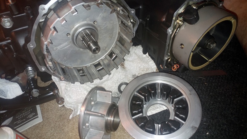

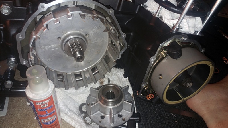

Fast track - look at the photos.
Better than new! Some discoloration but that's due to the light. Wire brush was everywhere and no regrets there! LOL The things I take up my dignity for this motorcycle... hahsaha
All back in place ready fro the plates and the clutch cover. Wait - I will test it first with a new clutch cable and the handlebar installed! (soon!)
Peace of mind, priceless....

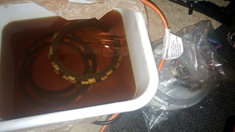

Soaking in oil from now. 2 days or more? Plenty of time until ready - I need to attach the handle bar and the clutch cable. Once done, and I see the clutch work, I will close it up with the beautifully chrome plated cover.

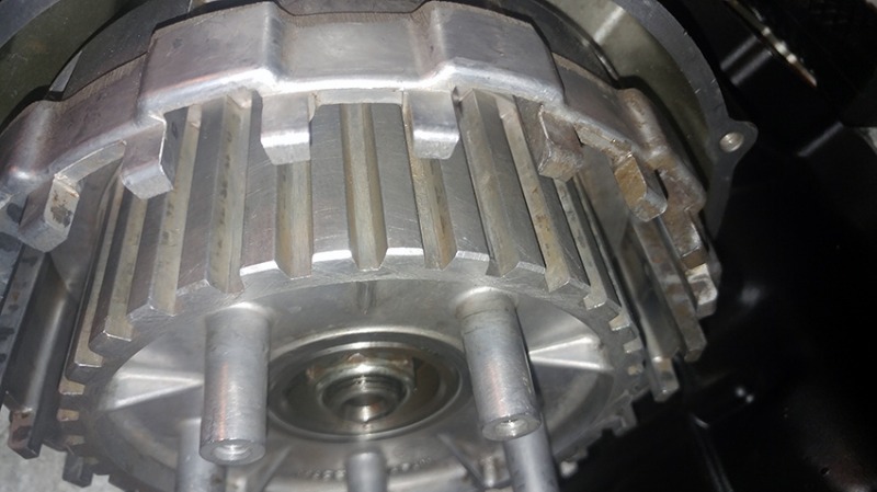

Lost my reference photo.
What is the steel and friction plate order? The manual reference diagram is useless. It was like 2 steel 1 friction, but forgot which one comes first

I think I got it figured out looking at the forensics
One remark to pay attention to: when tightening the big nut, make sure the shim/spacer that goes below it has the mark 'OUT SIDE' stamped on it facing outside.
Took a photo of it but the camera died and got nothing. Don't want to take it all apart just to picture it again. As me if confused.
