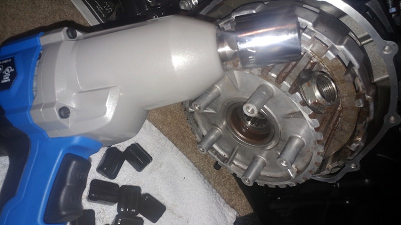

Unless you have the Kawasaki tool for holding the basket the only way to remove it is to impact the nut off while the basket is free to rotate. You can either use a socket and air impact, or a socket on a short bar and smack the bar with a hammer. Whatever you do don't try holding the basket with a strap wrench as you'll crush the basket. And don't jamb a bar across the tangs on the basket 'cause you'll break off one of the tangs. Also remember that you have chains, (camshaft drive and water pump chains) lying down below, so you don't want the secondary shaft turning or you'll fudge up the chains.
Best option is the air impact and hold the basket with your spare hand.

Thank you Kawboy. I will try the 'smack the bar' method first. I've been paranoid about damaging the basket so yes, I stayed away from applying any pressures on it to jam it still. If the nut doesn't give way soon, I think I will just have to look into getting an electric impact gun. I've seen it done this way on the web, but I was trying to avoid the purchase... As always, I will report back how it went.

Found an online impact gun at the Canadian Tire - regular price 179.99 +tax, on special 53.99 +tax. Noooooo shit!!! With 40+ close to 5 stars reviews, it's a no brainier. The timing couldn't be better. Did I say it again - no coincidences!?
It took a few seconds to get that nut off. The gun is listed as 240 ft-lbs torque. Smooth as butter. The socket size - 27 mm.
Simple and all off for reference

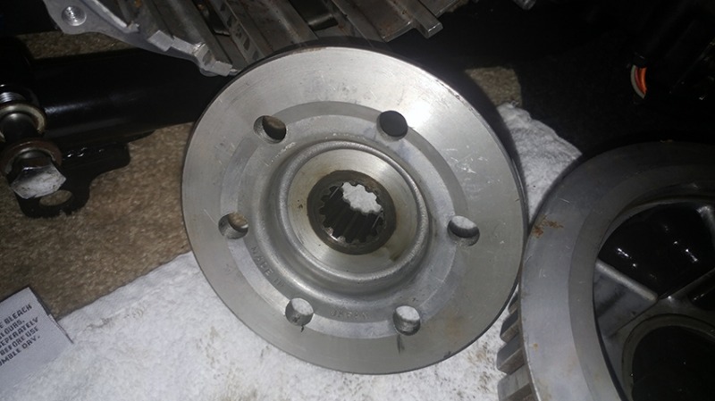

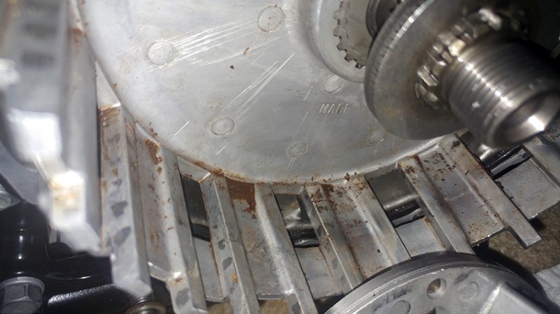

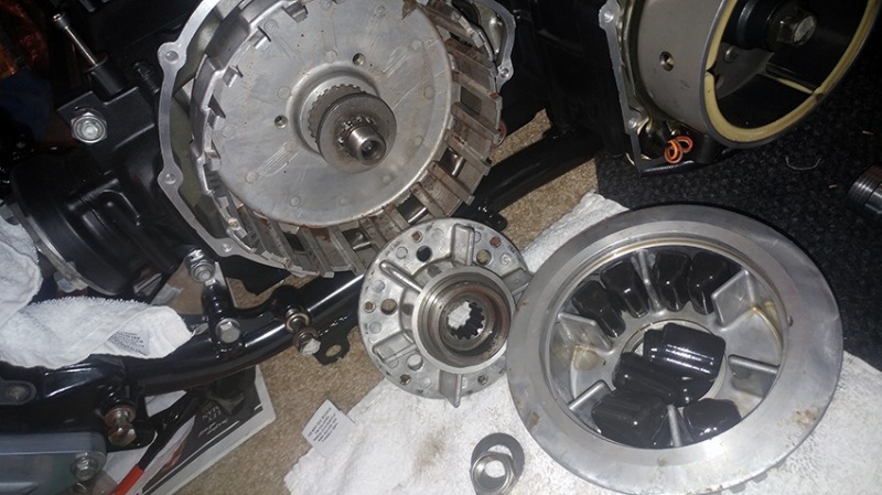

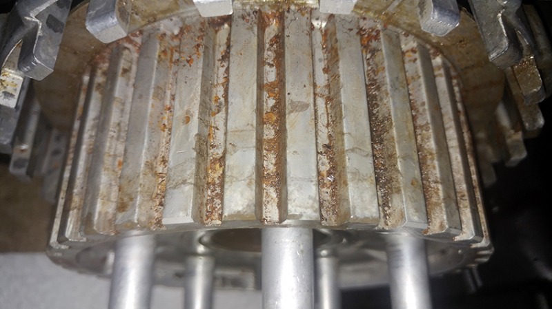

What's inside.
Shit looking surfaces difficult to clean when all is in one piece. It will be easy now!

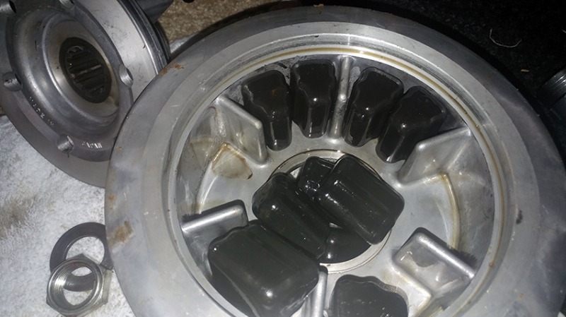

A bit more inside - I bet the oil would rinse this out, but where would the garbage go? Filter? After passing through crank shaft bearing? Nope, not worthy a chance.
The back side looks great - it means all the brown stuff is superficial. No need digging in deeper!
These rubber dumpers are clean and soft. Very happy. This confirms - no need to dig deeper.
Some cleaning and soaking the friction plates in fresh oil The clutch assembly will go back togeher soon.

Oh yeah, just to confirm and say thank you Kawboy again - the impact gun works!
Get one folks!
